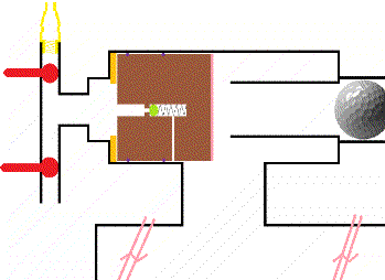

Here is the animation, just copy, your welcome, if anyone else wants animations just ask, its no problem, and i can use the practice
- in the flash version the spring valve lifts... gonna try to fix that... use the .swf if you want the spring to lift, cant get the export to hold it...

Two things wrong...
1) No surface area that is exposed to pressure on the face of the piston. It will not open.
2) It's very dark, if you make it again bring the barrel into the middle of the tee, make it smaller then the sealing face, add in a seperate pilot valve too. So you have a fill and pilot valve. Also slow it down.
Edit: Oh and generally pistons aren't normally closed, start with the piston against the end cap. The check valve is a nice touch, not sure if it will confuse though.

Grrr... making you happy will never be easy... here is a nice new one, which is good enough to demonstrate how it works...

I hate to be picky, but the barrel should be smaller, so that one can see more clearly how there is pressure on the leading edge of the piston, pushing it back when you dump the pressure behind it.

I just made this tonight. I'll be using it for my new 2" piston how-to that i'll be making in a few days. Way better then my old one.
I made it in three different speeds, 12fps, 5fps and 2fps.
Edit: Wow the quality is pretty shotty, oh well you get the point.
Edit 2: You have to click on them btw. Wonder why they came out so bad? They're fine in Flash MX. I'll see if I can upgrade the quality because I think it shrunk the pixel size which made it look bad.
Let me know if you want them, and if so which ones. I'll see if I can make the quality a lot better.

That is exactly like Clide's slider, except without the sleeve valve pilot/fill. Good animation though, it just looks kinda funny before you click full view.

Yeah thanks, on Flash MX it's perfect quality, so I think when I saved it I had the quality settings low or something.Hailfire753 wrote:That is exactly like Clide's slider, except without the sleeve valve pilot/fill. Good animation though, it just looks kinda funny before you click full view.
It a nice animation crowley, but there is one think wrong.
The check valve in the piston is not right.
Because of the srpring it should reseat as soon as the pressure on both sides is equal. (thus the gun is fully pressurized)
Yours reseats when its pilotted.

Yeah I wasn't too sure about that because on one hand you have the spring trying to reseat it, and on the other fixing the check valve ball to the spring might decrease it's area. Meaning less force is acting on it.psycix wrote:It a nice animation crowley, but there is one think wrong.
It should be an easy fix, it's only a few frames.
