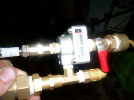

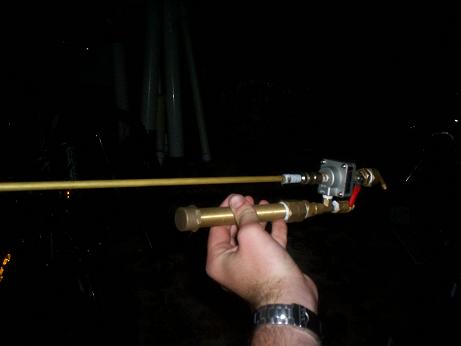

heres pics of my above mentioned bb gun:
- here it is, 1/4" SMC Pnuematics QEV as a valve
- fhdjdsjhdg.jpg (16.33 KiB) Viewed 3396 times
- gjdfgjgj.jpg (23.6 KiB) Viewed 3396 times
- dfgjgjfgj.jpg (18.55 KiB) Viewed 3396 times

wow that looks umm decent !! very nice
