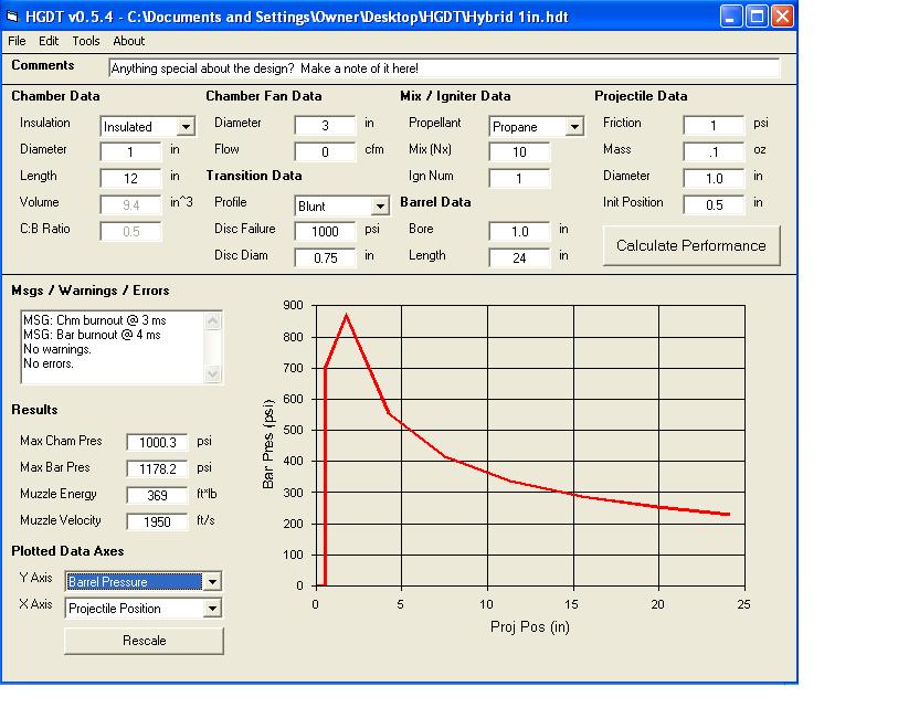

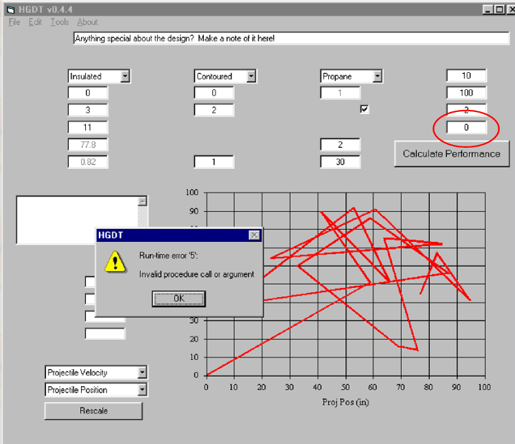

I get that runtime error when I attempt to input points for the perfect hybrid.

Not sure if the new version has this problem but 0.4 did strange things when the "init position" was set to a small value. This was modeling 1x gun without any burst disk (burst pressure=0). You get the crazy graph and HGDT crashes.

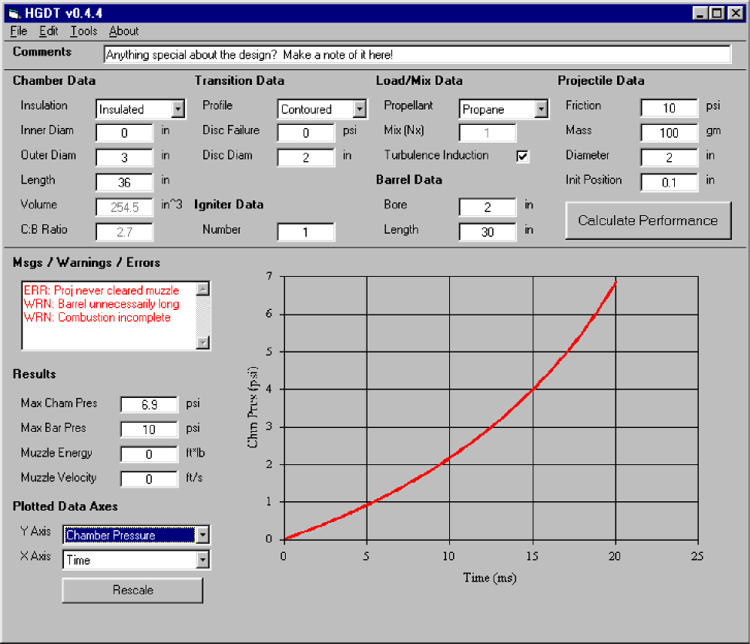

There also seemed to be some strange interaction with "init position" and other parts of the model. With "init position" set to 0.1", and using an oversized chamber (CB 2.7) I get "Barrel unnecessarily long" warning and "Proj never cleared barrel" error. That doesn't make sense for an oversized chamber. If "Init Position" changed back to the default 0.5" then the errors go away.

Those two problems are directly related to each other. I believe the first one should be gone and the second minimized... But the second may show it's face from time to time.
When the disk bursts and mass is introduced to the barrel, well, a small amount of mass is introduced. The problem is that I use a finite time step and the mass flow is constant throughout that step. At the end of the step, a very small mass flow introduced into a VERY VERY small volume results in a very high pressure: a pressure higher than the chamber (obviously, this wouldn't happen in the real world).
The projectile starts to move forward and...
The next timestep, the flow reverses. We again have the "too much mass moved in too much time" problem and now the pressure in the barrel is VERY low. A vacuum is formed.
The projectile gets pulled backward and...
...The simulation interprets that as a projectile that has run down a very long barrel, stopped, and is now being pulled back into the chamber.

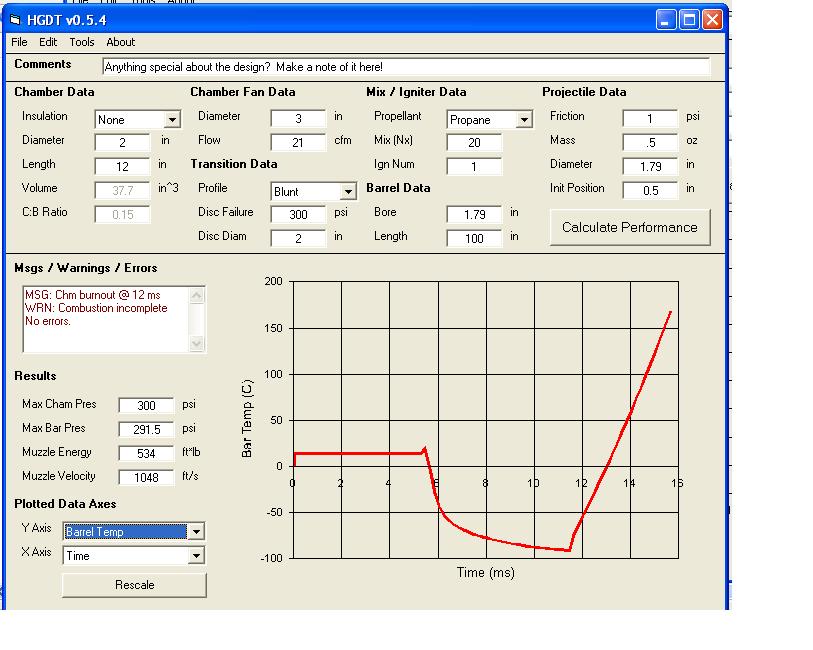

I just DLed the latest version of HGDT today, and several oddities occurred
Not sure how these things happened...
also, any chance you could add the option of using pure O2, rather than just air?
my barrel froze?
my barrel froze?
Max barrel pressure doesnt match in the text and graph

Lentamentalisk wrote:I just DLed the latest version of HGDT today, and several oddities occurred
Regarding the "cold barrel": You set your burst diaphram to go almost the moment combustion started. In essence, your gun was running as a straight up pneumatic. The only reason why the chamber burned out so quickly is because most of the unburned fuel/air had already left the chamber and was in the barrel. The rise of the barrel temp towards the end was when the gases in the barrel started to burn.
Regarding the plot/text mismatch: The plots only show one in every 25 data points. There's just tooo damned much to plot otherwise. If things are happening very fast, it's totally possible for the plot to miss things. Notice how the plot in your case is very spikey (ie, not a smooth curve)? That's a good indicator that it wasn't keeping up. This is WHY the text is there.
