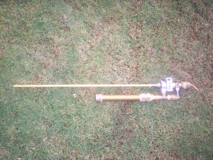

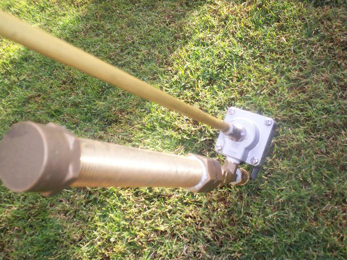

Hi all,
This is a creation i made using my 1/4" SMC QEV i purchased a while back.
Valve: 1/4" QEV
Barrel: 30cm of 4.5mm brass
Chamber: 15mm brass nipple
Pilot: 1/4" BV
Fill: Scrader
Its name TG6 stands for Test Gun 6mm and is this because of its purpose other than destroying crap with lead splitshot...testing the world of QEVs and boy was i impressed!
This can punch a lead bb through 3/4" ply at 250psi easy done. i mainly use it at 250 thanks to my HP floor pump which i got before MrCrowley lol

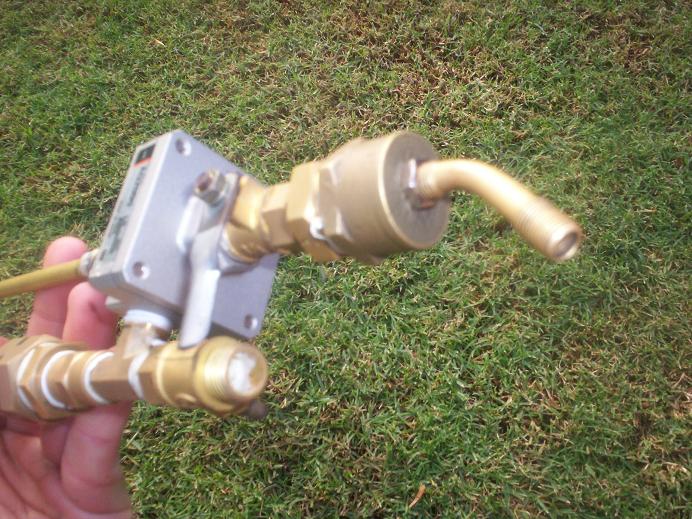

The pilot valve, 1/4" BV, pilots through the cored scrader valve (fill).
it is breachloaded by unscrewing barrel out of valve, i cut half thethreads of nipple.

whole gun
whole gun
frontside
frontside

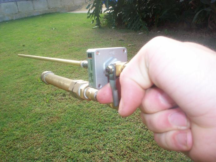

pilot/fill setup
pilot/fill setup
fits very nicely into my hand.

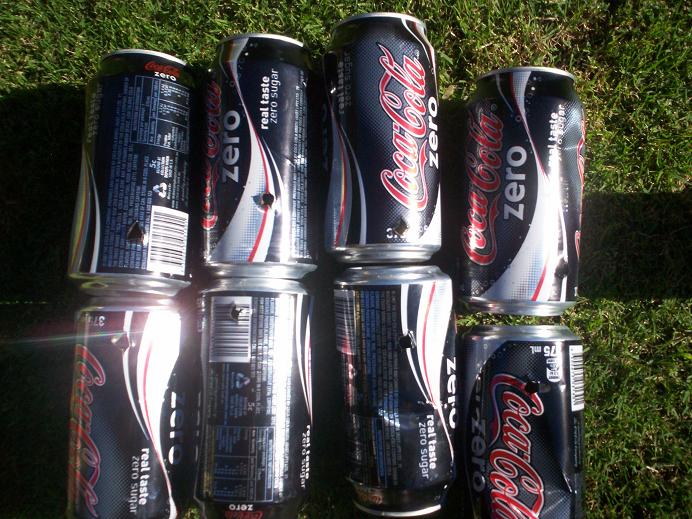

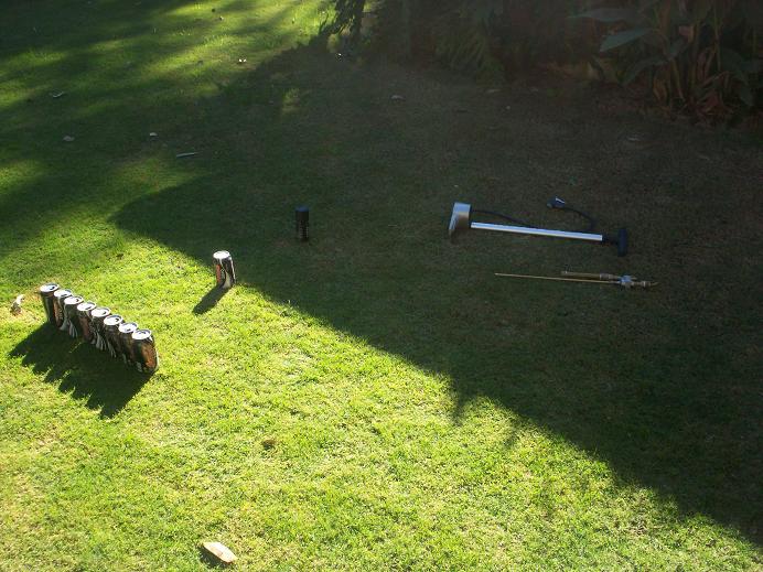

heres damage guys
ammo was steel 4.5mm bbs
didn't get much but its a start.
all shots were at 240psi
8 coke cans

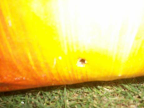

full coke can
deo can half full
all 8 have exit holes
backstop
backstop
hydrofication (sp?)
hydrofication (sp?)

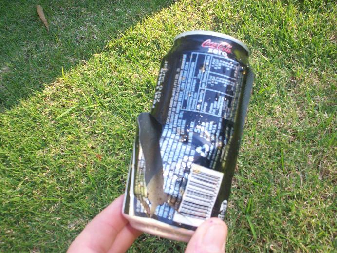

deo can
deo can
deo can
deo can

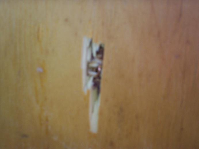

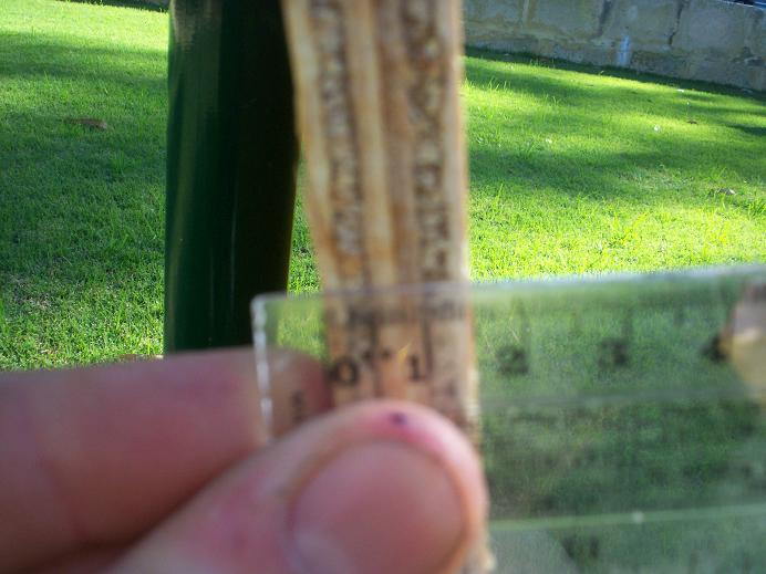

side of ply<br /><br />sorry guys it was 1/2&amp;quot; not 3/4&amp;quot;
side of ply
sorry guys it was 1/2&quot; not 3/4&quot;
entry
entry
exit
exit

good one on putting the ball valve so close to the QEV, almost illiminating pilot volume. that helps a lot.
@ lentamentalisk: i agree with you, so carlman, how about springloading the ballvalve?
really good quote/phrase here
Carlman
Posts: 1618
Location: Western Australia
Sun Jun 22, 2008 2:09 am
the only thing with spring loading is that the way i fill it is oen BV pump close BV take off pump then open BV to fire. If i was to spring load it i would need to hold it closed because there isn't much room for a nice mech to open it in there.
it is nice to open as it and im probably going to make the handle more trigger like soon.
Yea it has almost no pilot vol, its great :D
