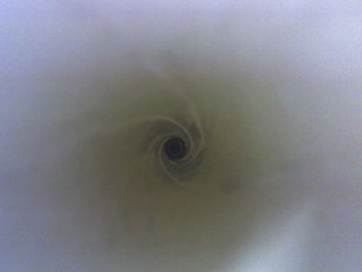

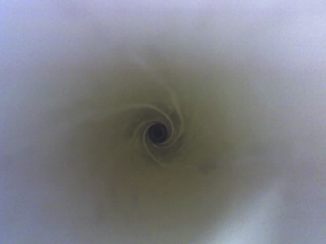

I think I'm going to try this on my 1" barrel. I'm making the rifling tool out of a 7/8" dowel and some 1" wood screws. If I come up with anything good then I'll be sure to post it. The method seems to work fine on PVC though from the little bit of messing around I've done so far.
Update: I just tried using this method on a piece of 1" PVC pipe around 36" long. However, instead of trying to pull the dowel through the barrel, my friend slowly tapped it through with a hammer while I twisted the pipe with my hands. It seemed to work pretty well and we got a pretty even spiral. We just finished testing some projectiles made from short sections of 1" wooden dowel wrapped in tape with a screw through the center as a weight. The results were good and the projectiles were flying, as far as I could tell, very straight. However, I want to do some more experimenting since I was only using the gun at around 20psi as to not scare the neighbors. I could definitely see where the grooves cut into the projectile which was pretty cool.

Managed to rifle a ~1m section of 1/2 in SCH 40 using this technique. However, when I pushed my ammo down the barrel (I used a 1/4" Carriage bolt inside a nerf dart with the head cut off and partially wrapped in duct tape) it didn't seem to be spun by the rifling. What type of ammo are people using with rifled barrels, and can anyone confirm that the grooves produced this way actually do rotate the projectile?

I just tested out this method with a 54" rifled barrel and surprisingly had some convincing success. I made a projectile out of a snuggly fitting 1" wooden dowel with a screw and nut in the top. I then fired it from 50ft at about 30psi (I was in a backyard and wanted to keep it quiet) at a piece of scrap metal. I was able to get consistently straight shots which all impacted on the head of the screw (I could easily spot the "+" shaped indents made in the metal). When I shot the projectile straight up at low pressure I could see the projectile rotating with only a slight wobble. I can't wait to see what happens at higher pressures.
