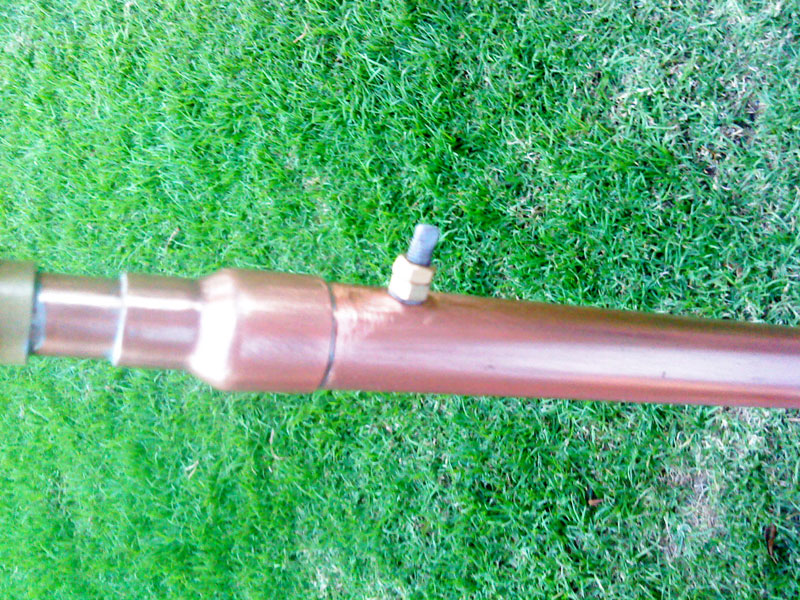

I only took a little flux and put some on the 22 mm pipe then warm it up until the flux melt then I took a copper bolt and lined it up on the melted flux. You then cut off a small piece of solder and drop it in the middle of the bolt and warm it up until it melts and add more solder if needed.
I will take pics and a vid of how to.

Thank ya! The bolts attached like that look so clean... i just cant get over it...... overall, this is basically my dream cannon. powerful, small, and ergonomic.BlackH wrote:I only took a little flux and put some on the 22 mm pipe then warm it up until the flux melt then I took a copper bolt and lined it up on the melted flux. You then cut off a small piece of solder and drop it in the middle of the bolt and warm it up until it melts and add more solder if needed.
