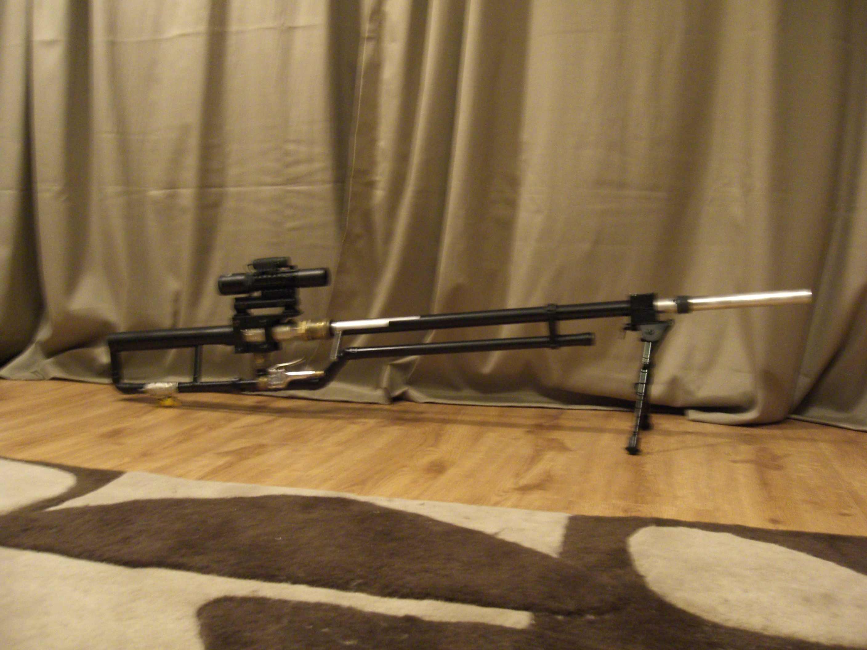

Hi, I'm new here so I Thought I'd introduce myself with some of my work before bombarding people with questions. I put this together about a year ago so you won't see any state of the art cannonage here, but it's not a bad performing pneumatic, some people might have seen this before on UKSGC.
Gun stats
Chamber: 22mm copper
barrel: 1" thick walled aluminium
valve: 3/4" QEV
operating pressure :150psi

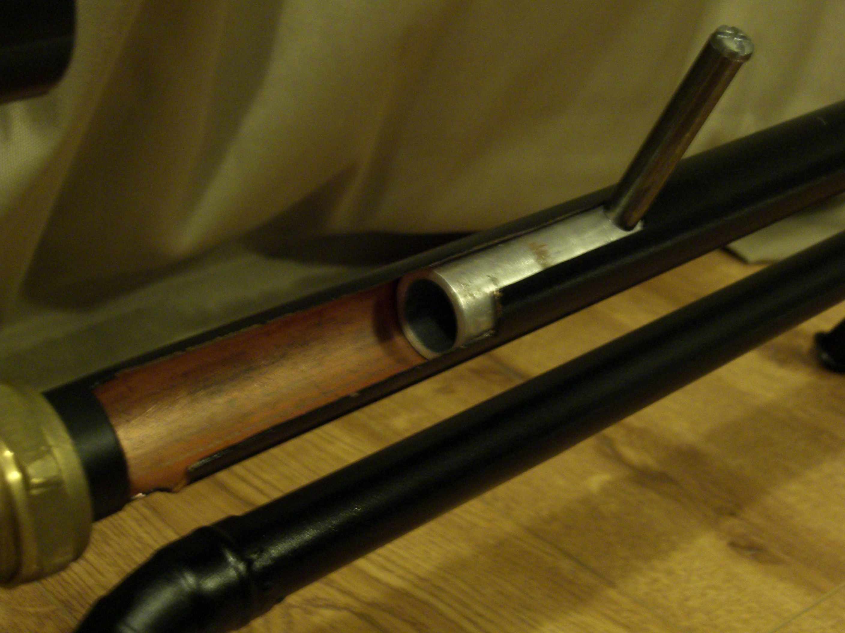

One of the more interesting features is the breach loader, I have managed to avoid the use of a pipe clip in here by using a thick walled barrel and threading the bolt directly into it.
the suppressor also works and probably took longer to built than the rest of the cannon put together, it can be screwed on and off of the barrel.

breech closed
breech closed
breech open
breech open
suppressor removed
suppressor removed
cannon, with suppressor attached

Thanks, I'm a fan of bullpups myself, ok this isn't a real pullpup but the stock is fairly useful, being half of my chamber.
Poland_spud, I agree, the only thing that might cause problems would be the crappy blowgun but that needs replacing anyway. Unfortunately I currently have no way of getting up to 300 psi.

Even though it probably doesnt work
It works a bit, hard to say objectively how much, If you listen to the vid the first couple of shots fired without the 'barrel extension' have a noticably different tone to the other shots. I suspect there's more of a difference down range.

love the bolt action myn always leaks any body now how to seal it

twizi wrote:love the bolt action myn always leaks any body now how to seal it
O-rings my friend.

Fri Dec 12, 2008 4:55 pm
how did u conect ur bolt to ur barrel?
