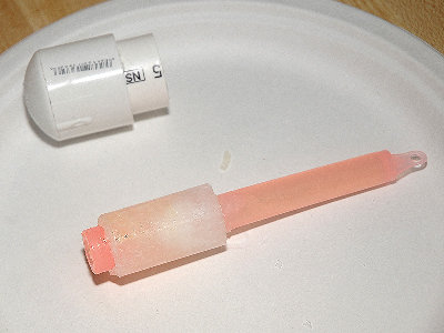

I've been making these and launching them from my 1" pneumatic cannon. Pretty easy to make and I can get glowsticks at the dollar store.

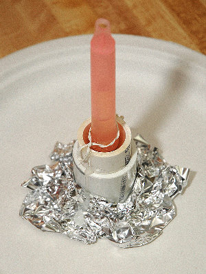

I use a piece of 1" pipe and a 1" cap as a mold. Aluminum foil is used to hold the mold upright. I give the mold a quick spray of Pam cooking spray on the inside to help release the parafin.
I melt the parafin in a foil pan in a skillet of water. I pour the parafin into the mold to a depth of about 1.5". I let it cool for about 15 minutes, then put the entire mold in the freezer until the wax is solid.
Be sure not to bend the glowstick while you are removing it from the mold. You don't want to activate it until it's time to fire it.

Cool cool, how did you keep the wax from forming all the way to the bottom of the endcap?
It flows all the way to the bottom on the first mold, but that piece tends to break off and stay in the mold when I remove the glowstick. That makes it easier on subsequent castings.starman wrote:Cool cool, how did you keep the wax from forming all the way to the bottom of the endcap?
JRRDW - It isn't hard at all to activate the glowstick without breaking the wax. I'm using baker's wax which is slightly soft even when cooled. It has enough flex to survive multiple launches as long as it lands on grass or dirt.

I gotcha. Nice work Photo..!PhotoKirk wrote:It flows all the way to the bottom on the first mold, but that piece tends to break off and stay in the mold when I remove the glowstick. That makes it easier on subsequent castings.
