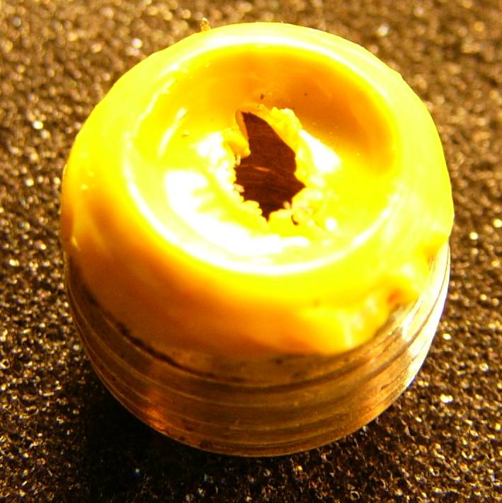

I found three layers burst at around 40 psi, so I tried ten and that held at 120. But maybe it was how the disk was held, because if you look at the picture you can see how sharply it crimps the disk. Maybe it's getting weakened at that point. Anyone tested smaller disks like this before?

Ended up not actually using the aluminum foil, because the o-ring was getting squished down into the chamber and not sealing well. Maybe a different size or a washer instead would work. For now I used tape.

Looks like I need to find a way to get the foil to work because the tape is too tough.

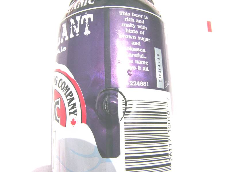

- Top one is from 8.8g through can, bottom is 25.9g.

Just wondering, the shot on the can, is it a dent or did the projectile pass through leaving a flap of the can?
I think you need to find a better birst disk material, the way that piece of tape burst meant that it was restricting flow
You should try the aluminium foil again, it gives alot better and cleaner break

i reckon the tape must have heated up and stretched out or something...

A way to gure the o-ring being pushed into the chamber is to add a washer after the aluminium foil
The way that the fitting is cut, means that it hasn't got a flat face, if you add a washer (Remember to have as big hole in the middle as you can)
which will stop the o-ring being pushed into the chamber
I think that you should also add a washer behiend the o-ring which I think will help in sealing aswel

It cut a flap but it didn't pass through because it was tight against the board, ended up inside the can.

I think the burst disk is having more of an effect than the barrel diameter, because I used a piece of aluminum from the can as a disk with a piece of tape to help seal and it seemed about twice as powerful. Also have to remember it's only a 1 cu in chamber. But a smaller barrel would increase penetration probably. And I found a place locally I can get a 24" .22 crosman barrel for $22, which would open the door to manufactured ammo. So it is something to consider.
That's a good idea about the washer, I'll try it out if the current method stops working.
