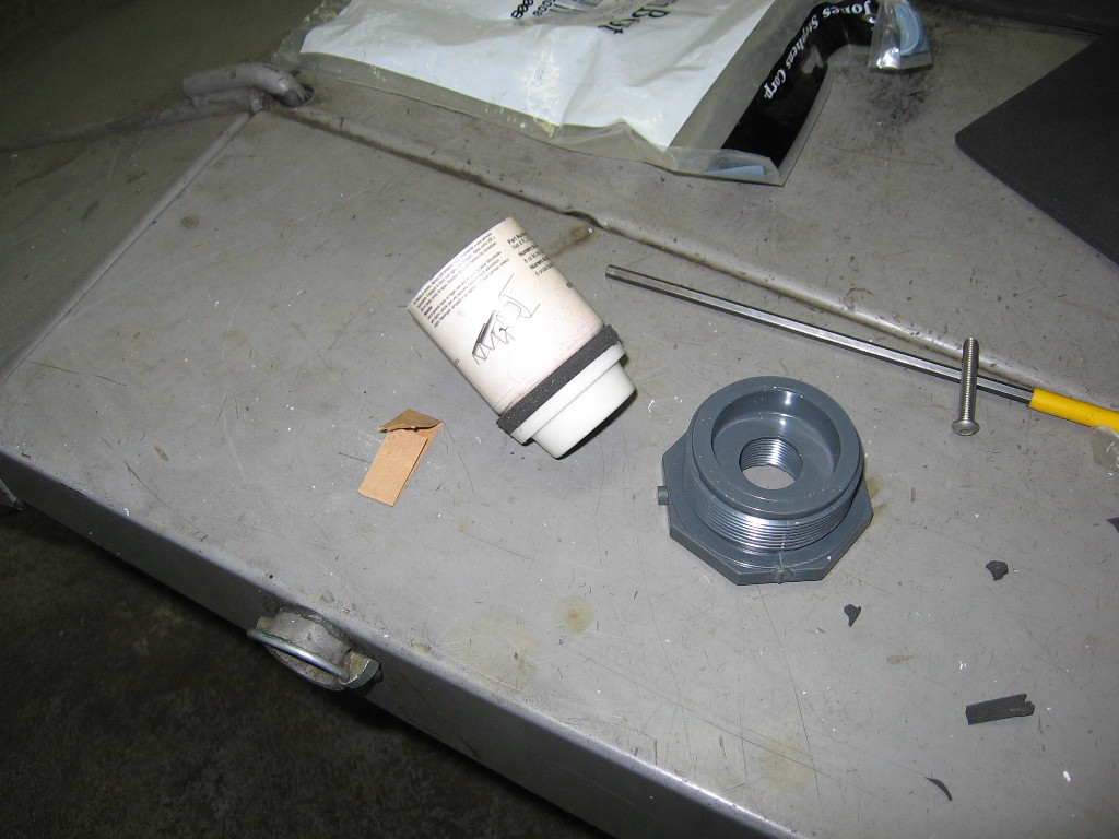

I've used neoprene sheet (copper guns) and a buna o-ring for bumpers.
Several hundred shots through the copper guns and my pvc gun, with no signs of failure.
