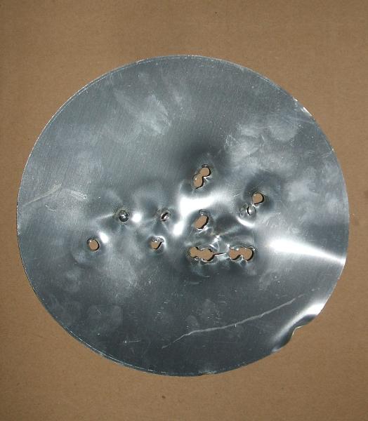

To hell with single shot testing, couldn't wait to try it out with pellets :)
Ten round bursts using unmodded 0.22" (5.5mm) airgun pellets in a 6mm barrel at 100 psi, firing at a 0.5mm (0.02") thick aluminium plate target. The second video is with a greater flow into the chamber and therefore greater rate of fire.

Unfortunately with the smaller calibre power is down from what it had been with pellets, here's what happened with the 0.5mm aluminium plate, most rounds failed to penetrate it - no video though, too many BBs flying back at my face :roll: but with 450-850 psi on tap eventually it should be a blast, literally :D
entry
entry
exit
exit
