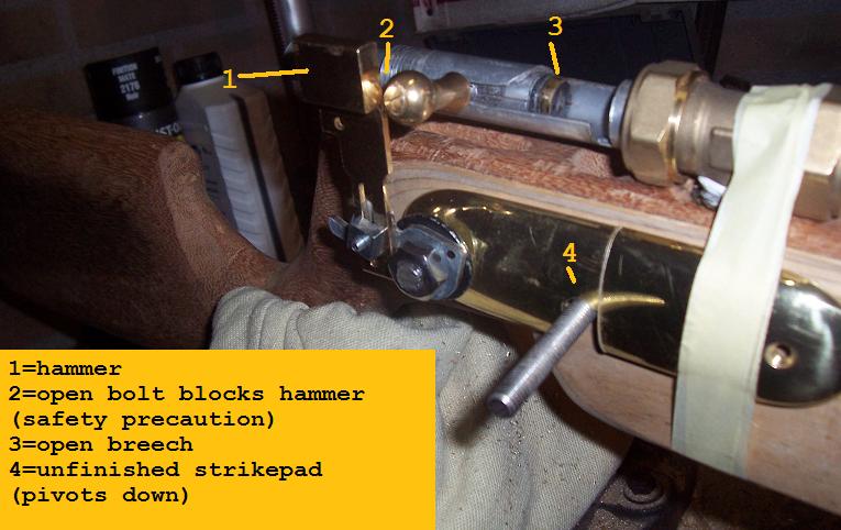

What will do what?<br />Not all parts are done.The square axle will hold the hammer.The sear on it will be blocked by the trigger on the inside.Hence the square shape.I still need to build a hammerpad, an anvill, a hammer...etc etc etc..<br />Not done yet....
What will do what?
Not done yet....

I can't believe you guys made me double post for this...
What?
Not a single reply after the latest pics?
I must be loosing it.. :?
Well, hope this works:
