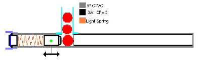

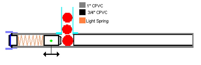

First of all I can't fully claim this as my own. I did see a chamber set up like this one on this sight that dealt with semi auto by Mr. Plow. However, that post did not go in too much detail as to what or how those tubes and regulators were used. So I made my own version . I first had to figure out the action. I used 3/4" CPVC inside 1" CPVC. The 3/4 " is just the right size with enough clearance to slide inside 1". Check the diagram below.

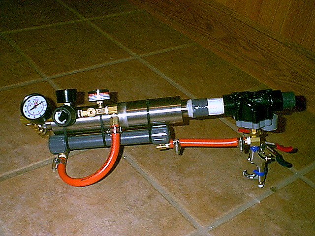

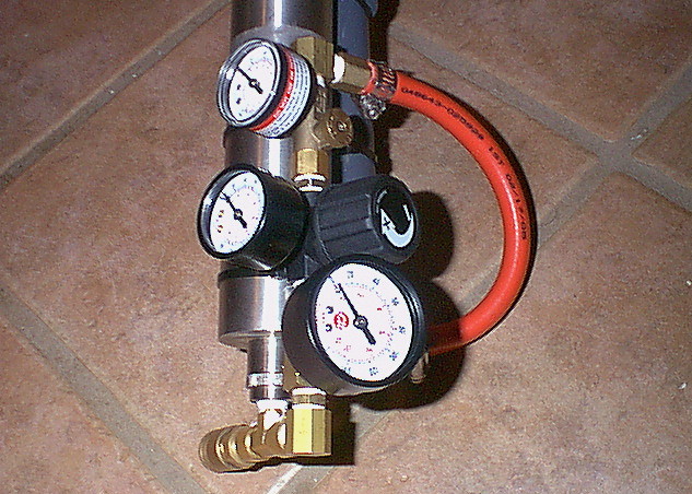

The chamber section has an additional secondary air tank made from sch 80 PVC. It stores air at a certain pressure to blowback the action. The gauges might seem confusing, so here is their purpose back to front. The first gauge tells me the overall pressure of the cannon. The second gauge is a regulator to limit how much air gets into the second chamber.
The third gauge is a flow control. When you reduce pressure on a regulator or the air going into it, it equalizes the air or gas and bleeds some of it off. The third gauge with the flow controll slows down the air leaving the secondary chamber. That way there is still enough pressure left to recycle the next round. see picture for details.

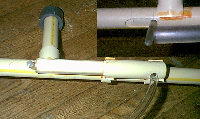

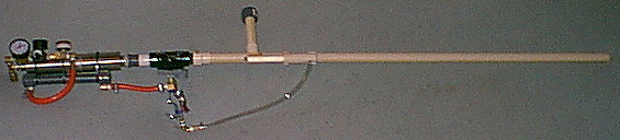

There is a second blowgun on the cannon. It acts as a valve to the homemade air ram on the side of the barrel. It is setup to release air into the air cylinder after the cannon has fired. I know there are otherways to get semi auto, but I do not have access to a decent lathe. So this is the methond I chose. Anyways here are a collection of pictures of the setup

The metalic chamber fills with air to 135 PSI, the second chamber is regulated to 60 PSI. When the cannon is fired all of the air in the first chamber is expelled propelling the paintball @ appox. 750-812 FPS. The second chamber stores up enough air to blow back the action. Since the regulator is not a check valve, air in the second chamber will start to escape. Since I could not find a check valve at my local hardware store, or feel like ordering one, I use a flow control valve to slow the air leaving the secondary chamber. This also slows the air filling the chamber, but not by much. The flow control is under the third gauge. I'm not sure on the rate of fire, but it is close to 2-3 per second. The hopper pictured on the gun can hold 9 PBs. It was just a piece I had cut that was lying around, so I was not concerned with how many I wanted it to hold. When in use, it is connect to a constant air source.

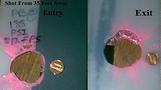

As for damage pics, I will try to post some. I can say that this gun is similar in power to the other one I made. It shattered 1/4 acrylic with no problem 40 feet away

Last night when I shot it, it was more like 1.2-2 a second. When I posted my first gun GGDT quoted my FPS @ 812. I took the specs for a 1" sprinkler valve off the GGDT site. I dumbed down the specs a little. Rainbirds open slower than Watermasters. And the specs came back as 812. like I said about my first gun, that seems slightly optimistic. I won't know for sure until I get ahold of my grandfathers chronograh. Based off the damage done to the 1/4 acrylic, I can say I would not want to get hit by a paintball at that speed.

GGDT calculations were not very close with this gun I chronographed the velocity at an average of 650-663 FPS. I did not take the actiion/bolt section into consideration when pluging in the numbers. It constricts the flow of air. I'm not disapointed at these results. this just tells me I need to improve the semi-auto action. 650, 800 I still would not want to get hit by a PB from this gun. So there you have it, a more realistic number I will say at this time that GGDT was not at fault but my own human error element. GGDT after all is a tool to help us get more potential out of our projects.

i cannot seem to find your first gun when i search "Gas Sampling Cylinder PB Rifle" so i wnat to ask about the barrel setup diagram, is that a picture of the gun at rest or is it while its blown back
