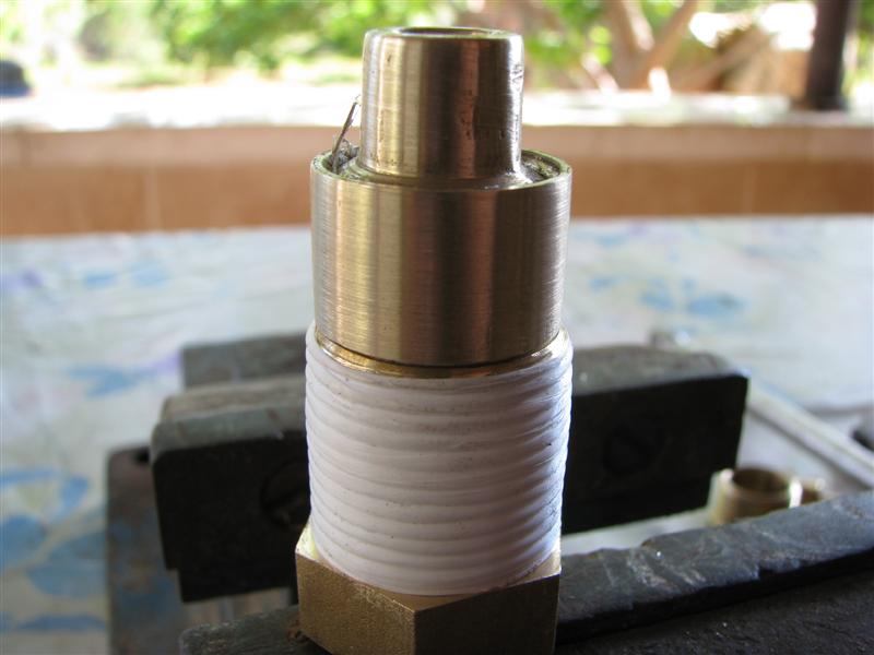

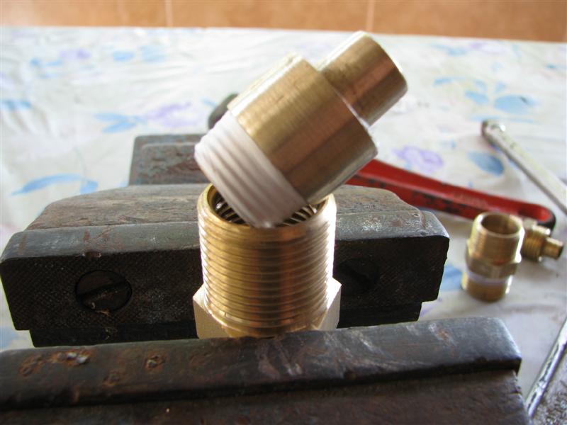

at last i build a piston valve and he work great
it's 3/4" T copper (or bras !!)
the piston made from wood , sweeper stick :D turn it on a lathe and he is about 18mm
and here is the video hoe fast he dump the air. the pressure is about 130 psi
dont forget to watch the video in HD .you know how :roll: :roll: :roll:

the piston
the piston

Mon May 11, 2009 12:45 pm
Congratulations on getting it right so it pops open. Nice home built QEV.
:D

Mon May 11, 2009 2:01 pm
Very nice job Far Cry. :)
You may have some trouble with the sealing face being retained at higher pressures, but only time (and pressure) will tell for sure.
You did a nice job rounding the piston seat too. :D
:thumbright: :thumbright:

Mon May 11, 2009 2:23 pm
Your Piston looks friggin' beautiful lol. It' looks so cleanly built.
Nioce Job.

Mon May 11, 2009 6:01 pm
Gorgeous!
Could probably cut down on Pilot volume in the back, And use a smaller Ball valve, But otherwise I'm Envious.
Whatcha gonna put it on?

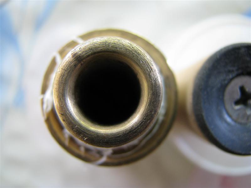

and what you did mean by You may have some trouble with the sealing face being retained at higher pressures
so may i have some leaks or the seal face stuck ? if so what i can do,, and the piston is temporary from wood .i will turn one from hard plastic or aluminium

Gippeto
Venezuela
Posts: 2504
Been thanked: 17 times
Mon May 11, 2009 6:48 pm
[quote="Gippeto"]You may have some trouble with the sealing face being retained at higher pressures quote]
What I mean;
With my bbgun, the teflon seat was "sucked" right out of the hole it was pressed into. This would seem to demonstrate that the flow creates a vacuum at the front of the piston.
Your sealing face "may" be pulled over the head of the screw by the flow.
If this does present itself as a problem, you could turn a washer from teflon or some other softer plastic (hdpe?) to use as the sealing face.
Harder sealing surfaces take more work to be successful, but also yield some small improvements in performance. :D
The screw should then be entirely adequate.(This was the case with my bbgun.) :D
far_cry
Posts: 317
Mon May 11, 2009 7:01 pm
i understand , the seal face will sucked into the barrel with high pressure because the strong vacuum
i will find solution after all
and , can this piston valve handle 1000 psi ? agnor the seal face issue
and i have alittle problem the long part ,seat face i put allot of teflon but he still leak what can i do

far_cry
Posts: 317
Mon May 11, 2009 7:17 pm
the leak is here what can i do ?

Mon May 11, 2009 7:33 pm
If you have access to a product called "Loctite", the blue variety should provide a seal.
Clean off the teflon tape, apply the loctite and tighten the pieces together.
Then leave it for a day or so. It'll seal.
500psi I think would be fine. Since I've not tested any brass/bronze fittings, I am hesitant to suggest more.
The "turned" fittings would be fine. It's the casted ones you need to watch out for.(the tee)

Very nice gun Far_Cry. I love it. Be careful with the piston though. I used lathed timber for a while until the wood swelled from the condensed air and vapor and the piston completely got stuck.
I solved this problem by putting on a coating of "super glue" to more or less seal it.
I now use hand machined aluminum. It's very easy to machine on a wood lathe, it just takes a little more time.
