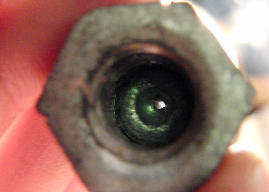

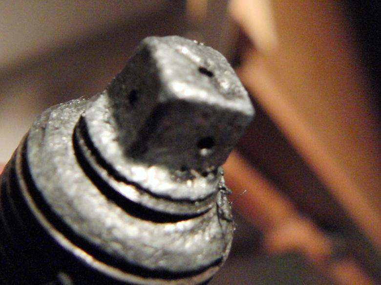

Fri Jul 17, 2009 10:00 am
I added a venturi type thing and still have problems! here are some pictures. Even after waiting 3 min, it won't fire. would the configuration shown in the first picture be a better configuration than the one in my first post?
Thanks

the ~.054 hole
the ~.054 hole
the drilled out 1/4" plug
GalFisk
Sweden
Posts: 113
Joined: Mon Feb 28, 2005 4:06 am
Tue Jul 28, 2009 4:25 am
Your spark plug is a bit "out of the way", so you may have a problem getting a good mixture at the spark (possibly in addition to general mixture issues). I have had similar problems with my hybrid. You could try placing the spark in the middle of the chamber to see if you get more reliable ignition.
