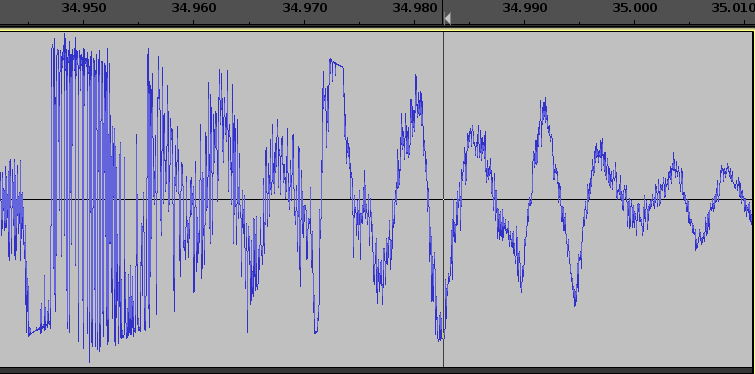

Here is the actual recording of one of my air cannon discharges. Note the waveform at 0.05 seconds after the start.
Mouse Musket Discharge sound.

Technician1002 wrote:Just for grins.. Take your time to travel 150 feet.. 0.0559 seconds and invert it. To detect the point in time, you need accuracy several orders of magnitude greater than the time interval.
I must not be following you. 1/0.0559 sec = 17.9Hz. Throw in a factor of 100 in frequency to get to a 1% sample error and you get 1.79KHz sample rate. Typical sound card has another order of magnitude resolution on top of that. A sound card shouldn't have any problem with the basic time frame. Dampend sine wave original signal, mutliple signals, echoes etc. may be a problem.
Technician1002 wrote:Two bangs arrive to the mic. The waveform from the first is still in peak amplitude when the second arrives, much weaker. S/N of the second is lost in the noise of the first.
Your phasing doesn't sound right. Say the gun resonates at 300Hz (WAG), time to first zero crossing is 1/300/2=1.7mS. But the impact times is at 55.9mS. Of course, it depends on where the mic is and the speed of the ammo.
At Mach 2 with a mic halfway from muzzle to target, muzzle blast gets to mic at time X, sound from round hitting target gets to mic at time 2X, where X is (muzzle to MIC distance)/(SOS). I think you still have 55.9mS from muzzle blast to "ding". The sound card shouldn't have any problem measuring a duration that long. Again, still have problems with digging a weak dampened since wave (ding) out of a strong dampened sine wave (bang).
Put one mic at the muzzle and on mic at the target. Or, a mic at the muzzle and tape a piezo transducer to the target (might be able to get away without any amp for the piezo). Sound cards in PC (but usually not laptops) have stereo left and right line inputs. Since the mics are well separated, and sound intensity drops off as 1/r<sup>2</sup>, it should be possible to mostly eliminate the unwanted sound from the two channels. Probably need a preamp for the mics to get them to work with a line input.
So it can be done. A supersonic marshmallow is kind of unusual. Heck, any supersonic shot is going to be more difficult.

Good post.
Take a look at the graph here:
http://arxiv.org/ftp/physics/papers/0601/0601102.pdf
It the target hit time is very easy to see.
The noise after the projectile leaves the muzzle is easy to ignore.

boyntonstu wrote:P.S. Can you suggest a method to take the .pdf graph and convert it to an image for uploading?
Like the attached?
On a PC;
Print screen button (Prt Scrn?), or Alt Print Screen (for just the active window)
Open MS Paint and paste in the screen shot
If you want, copy just the part of interest and paste into a new paint window.
Save the file as a gif.
Looking at the other images in that link reminds why I don't use a mic. :shock: You pretty much have to know what the answer is in order to interpret the soundgrams.
Thanks,
The positive going vertical spike lines of the muzzle and the bullet strike are very similar.
If you know the approximate muzzle velocity you can look at the ballpark region for the strike signal.
The other spikes are not believable.
(One can use a .22 at 1050 fps as a calibration)
To each their own, but 97% accuracy is good enough for me and the price is right.

Well done guys. Works for lead bullets. Thanks for the PDF.
Proof is better than theory any day. :)
On the photo, any OS with screen capture and any good photo editor.
I grabbed it and did it in Ubuntu using the Gimp before reading all the posts. Result is below.
Remington rifle sound chronograph
Remington sound.jpg (34.65 KiB) Viewed 3021 times
