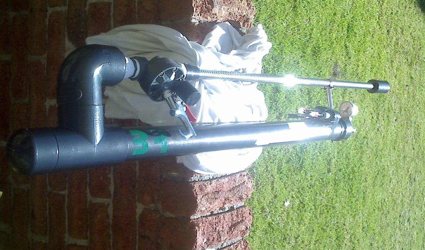

ist all good ,about the ball valva i went to bunnings the other day and got a sprinkler valve and modded it with a blow gun,it awsome now steady as a rock...and accurate ill post a pic tommorow its 11.00pm ..

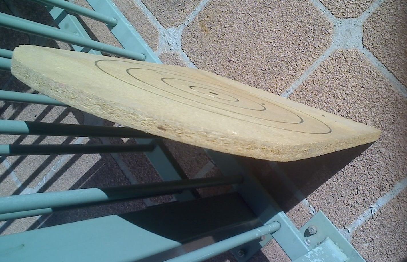

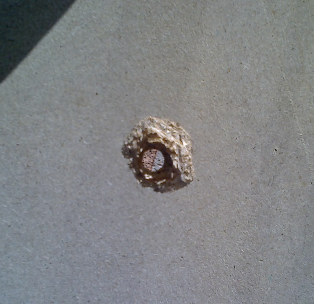

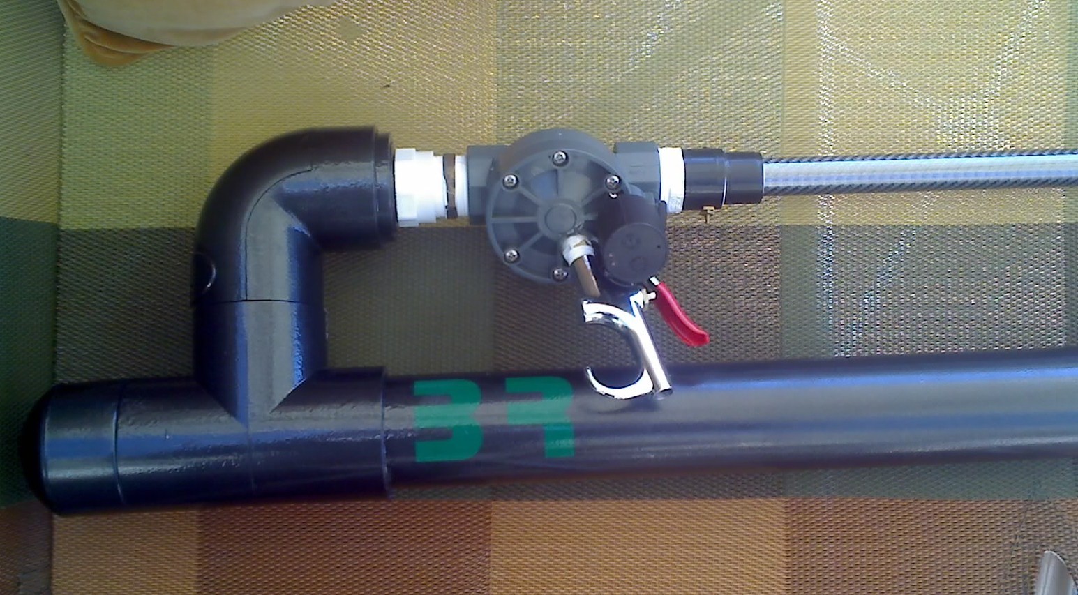

just an update to my last post, the modded sprinkler valve and a damage shot...
20mm thick particle board
exit wound...
exit wound...
the target entry hole next to bullseye,this was my first attemp at the target
full view
full view
new valve,,had to mod it on side of caseing because of guide rod..

see how much more powerfull the sprinkler is? i personaly have not used one but they are much better than a ballvalve but still not a piston valve.
Sun Jul 19, 2009 12:05 pm
Shame the chamber is still so big relative to the barrel, you're getting a lot of extra noise and filling effort without any real performance benefit.

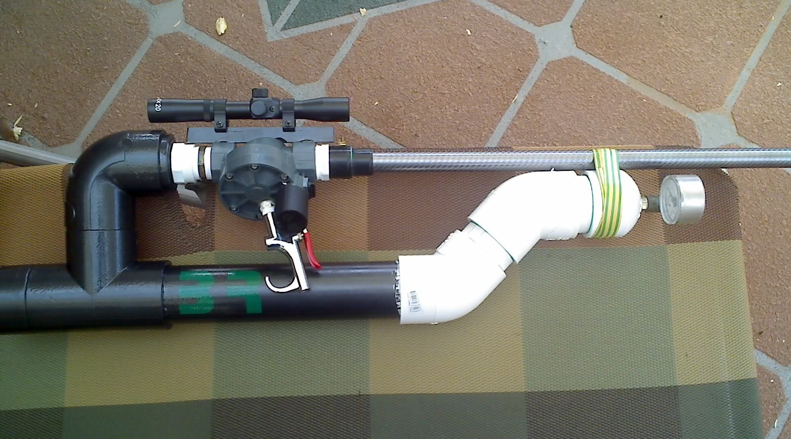

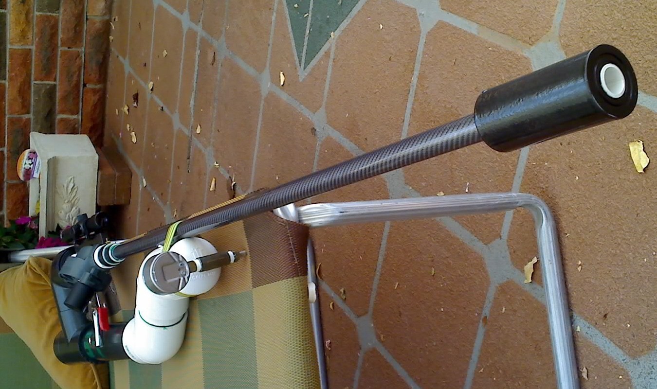

updated with scope mounted on a aluminium bar,fits perfectly. :arrow:
ergonomic...
ergonomic...
view looking through scope lens,it has improved aiming tenfold .
