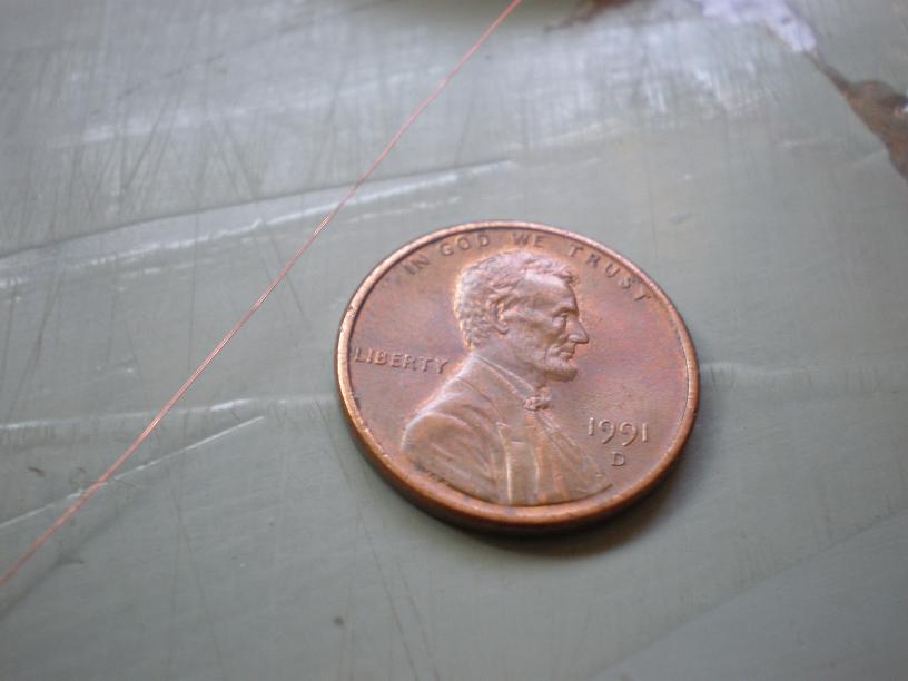

shows just how thin the copper wire is

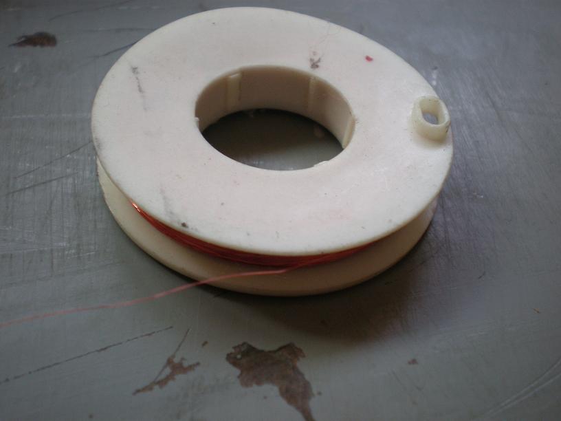

This is the copper wire I used I got this spool from an old AC motor.

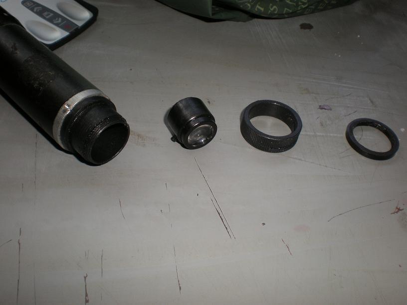

I removed a retaining ring and a focusing ring so I could remove the lens.
