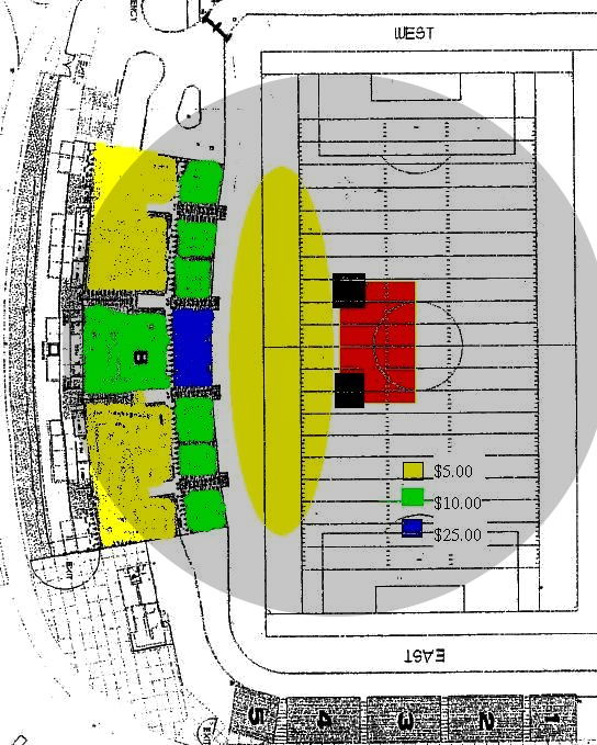

This launcher has a 100 yard tennis ball range.
Range of the shirt launcher overlaid on the stadium where it will be used Aug 8th.
