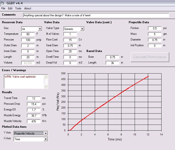

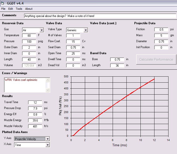

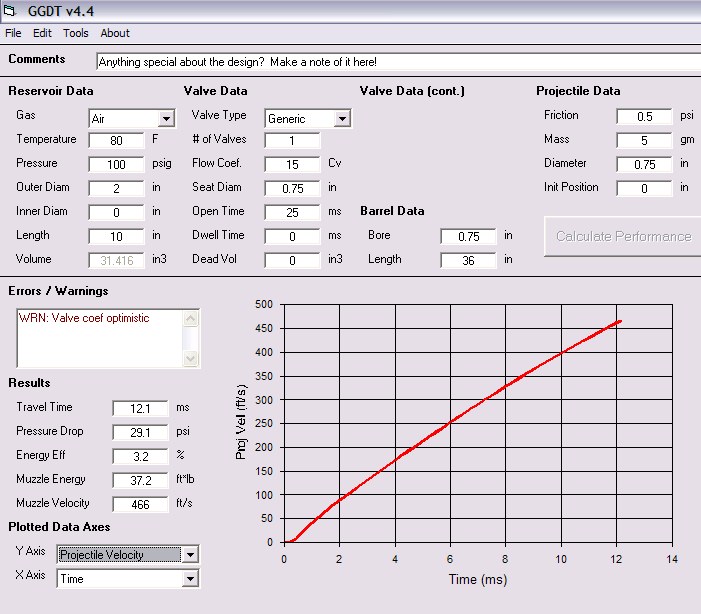

About chamber size, some practical examples of a launcher modelled close to yours.
Starting with a 10 inch chamber, you get a muzzle energy of 37.2 ft/lbs.
Increase chamber volume to 200%, muzzle energy is 38.7 ft/lbs - a mere 4% increase.
Increase chamber volume to 400% of the original, muzzle energy is now 39.6 ft/lbs - just 6% more muzzle energy, in practical terms you would never notice this increase without the benefit of a chronograph. In terms of filling the chamber though, you would certainly notice the difference, especially if filling by hand pump, and the shot would be much louder too.
