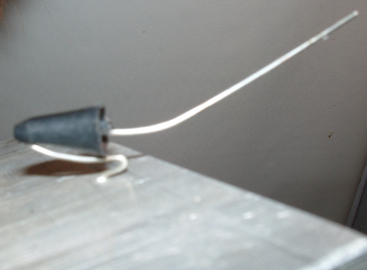

36 cal lead ball after impact with a 1/4 inch aluminum plate.

The damage is very cool. I've never seen .40 caliber darts mangle like that. I couldn't imagine doing that with the blowgun I've got. I'm very impressed to say the least from the power of the gun because the chamber volume seems so small, but then again your taking it to 300psi.
