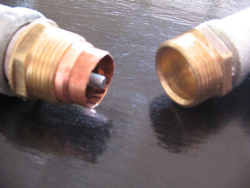

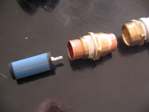

Ok, I have done a bit of work on this again.
Now I have added a bigger piston, exhaust valve(pilot), more galvinized fittings and a port for a female quick disconnect.
As you can see the piston housing after the valve(larger tee) is bigger. This is because the piston is now 20mm pvc. The people at the hardware store sold me irregular sized fittings which I can't get a link for, you can see that the piston housing needs to be linked. So what I have to do is get the two compression pieces and drill out the lip so the copper ring can still be there, then silver solder them together to make my own link. Too bad I don't have the tools to do that so I will have to find someone with them.
I have kept the space behind the piston to a minimum and it should work fine.
Check out the pics.
Here is the pvc piston and the rest of the body.
These parts are going to be the link.
Seen here is the open piston housing. This is the part I need to make a link for.
