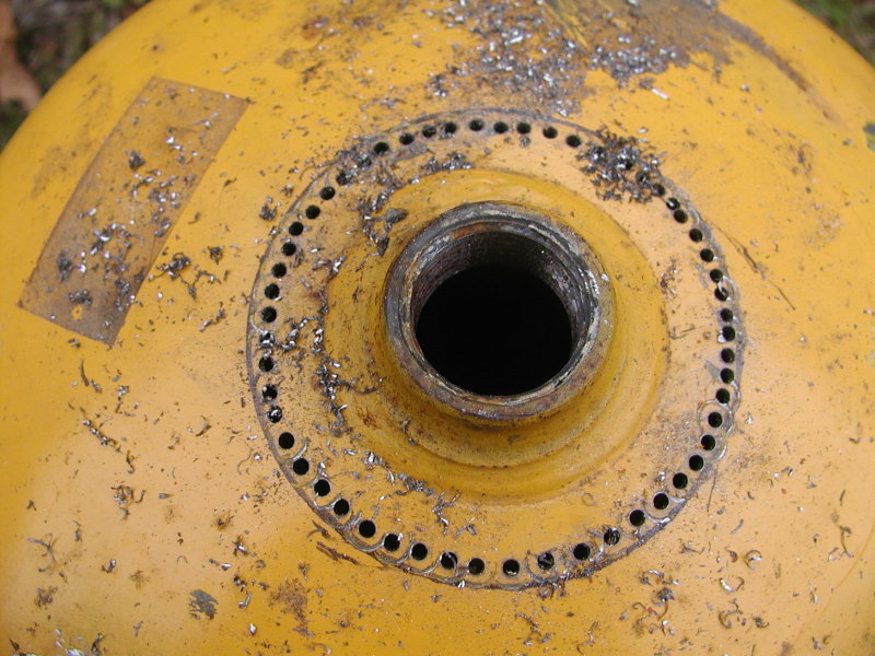

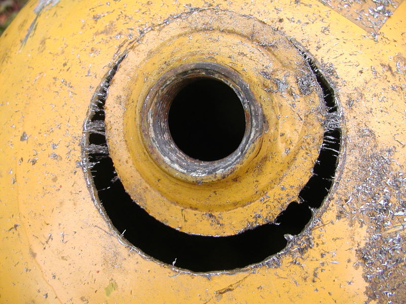

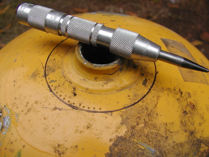

I made some progress today.  The items done today were the removal of the handle from the top of the tank and cutting the top so the tank is ready for welding.
If you wish to repeat this process, the steps are;
Cut off the handle with a hacksaw. Grind smooth.
Draw a circle the OD of the pipe
Make a ring of center punches inside the circle
Drill the ring of punches.
Enlarge the holes
Remove material between the holes
Trim and bevel until the pipe fits.
The bevel and enlarging of the hole to size is done with a ball peen hammer.
@ Brian, this is being designed to have a working pressure of 200 PSI. I will use it to develop a robust bumper for the 3 and 4 inch versions.

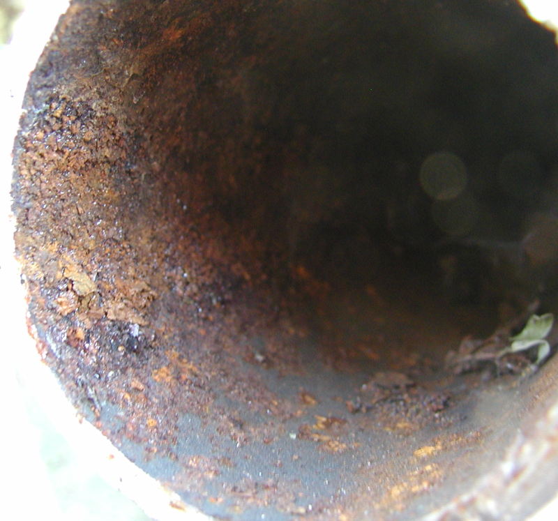

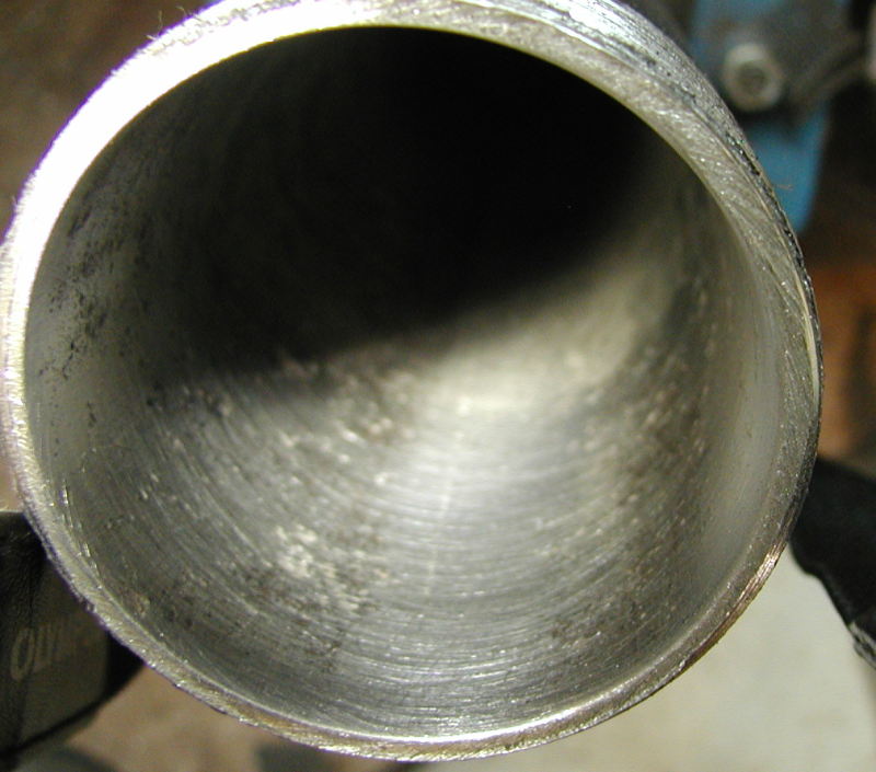

I've been sanding like crazy. The way I sanded it is to use self stick sanding pads and stick one edge onto a 2 inch ABS pipe. I stuffed paper towels under the flap to provide pressure. Then it was several sessions of getting a workout. First came off a layer of rust. Then I started to cut through the black pipe finish in the area of the seam. Now I'm starting to wear through the black finish down to steel all the way around and the full length. A couple more days sanding to sand down the seam and remove all the black finish is the goal before cutting ports.

Could you sand with the power drill and rod method?  I tried sanding like you are to hone the inside of a barrel and I almost died trying until I read someones how-to on "improving the barrel" (forgot their name sadly).  Their method actually works very well.  I was very pleased.  If you haven't read it and want to, i'll find the post for you.

You figured right. I moved to a power drill to drive the sanding process. Due to the large amount of scale and black pipe surface, I switched to 80 grit for the bulk sanding. I found a drywall sanding screen works well, but wears out quickly. This is much larger than the sanding job on the 2 inch or the Marshmallow cannon.Moonbogg wrote:Could you sand with the power drill and rod method? I tried sanding like you are to hone the inside of a barrel and I almost died trying until I read someones how-to on "improving the barrel" (forgot their name sadly). Their method actually works very well. I was very pleased. If you haven't read it and want to, i'll find the post for you.

The pitted areas where the rings will set will be sanded out with a soft backing so they are very rounded to permit the ring to seal. Deep pits will be epoxy filled and sanded smooth.

The entire length is sanded. More attention is given to the area the rings will seat. Due to the design and a planned piston stop to prevent the piston from launching, the piston will have to be serviced out the breech like the marshmallow cannon. Due to that, there can't be any high spots in the pipe. They are all sanded off. This is one of the reasons this valve is taking longer. The pipe is in worse shape to start with. I picked it because the seam is not in a deep valley like some I was considering. It's easier to sand off peaks then it is to fill in a valley. Some pipe has a terrible seam. Either a tall ridge or deep valley. I decided to deal with some rust pitting instead of a bad seam.MrCrowley wrote:Looking good, did you sand the entire length of the pipe?
It isn't a barrel its basically where the piston is held ... Good job on the build tech looks very clean. and much better than how it looked before you sanded that piece of pipe.... I wonder why the seam on some pipes are so big... in 1/2" galv. pipe its about 1mm tall, might want to look for some seamless steel piping...
