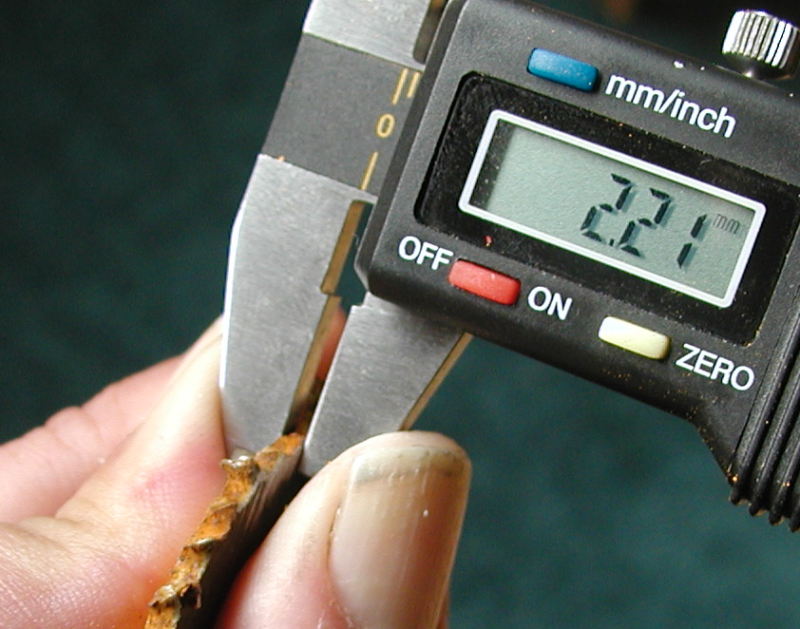

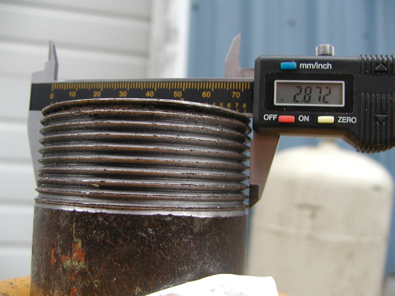

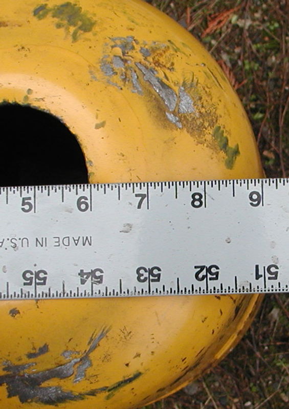

I got the measurements for Dewey-1. So everyone can see the parts measured, I took photos. Sorry for the more than 6 photos in one post.
Edit; adding to my last post instead of bumping the same day.. I got the ports cut. Photos below.

The ports are 1.5 inches tall. The ribs are .5 inches wide.dewey-1 wrote:Tech;
What are the sizes of ports and width of ribs before filing?
