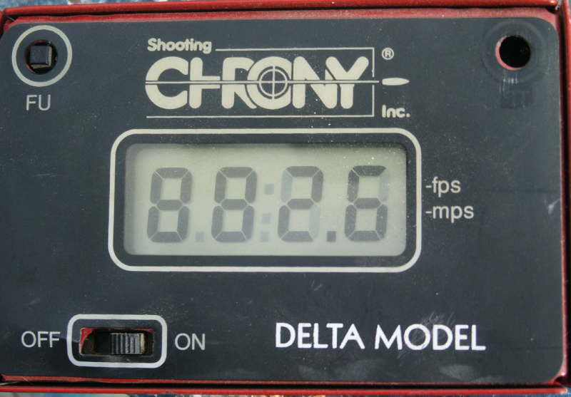

:D I'm working on the same thing. Bigger valve is on the workbench.
Chronograph reading on an apple.
Mon Nov 23, 2009 7:54 pm
On a related note, I added some substantial reinforcement to the chamber of my 6mm burst disk pneumatic to allow testing at 800 psi, scheduled for tomorrow :)

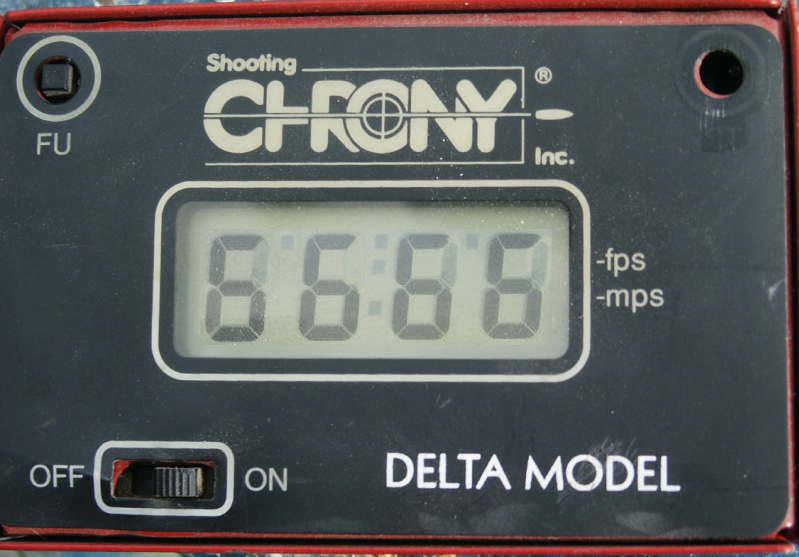

I may have cheated...
Definitely not photoshopped
Mon Nov 23, 2009 8:18 pm
Definitely not...
Mon Nov 23, 2009 10:28 pm
jackssmirkingrevenge wrote:Definitely not...
LOL.. I had to look at that one twice to notice the decimal points are on the top.. :D
Mon Nov 23, 2009 11:20 pm
Technician1002 wrote:LOL.. I had to look at that one twice to notice the decimal points are on the top.. :D
Yeah, I could have made a better job but believe it or not I actually have better things to do :P :D
