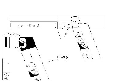

I just came up with an idea of building a vortex pistol. However, I have come across some problems with my first design.
The design starts out with the vortex block. What make it unique is that the vortex block is part of the mag. This would making reloading a lot easier. I think that once its built it will be a beast in airsoft wars.
The first problem is... how the hell am I going to power it?
-CO2 is out of the question, its just way to expensive
-I was thinking of maybe making an air tank and fitting it in a backpack
-Or i was thinking about incorporating the air inside the gun somehow
-I was thinking of doing this by having small cartrages that that would fit on the underside of the barrel (it might make it look like a robocop gun )
Votex mag pistol
