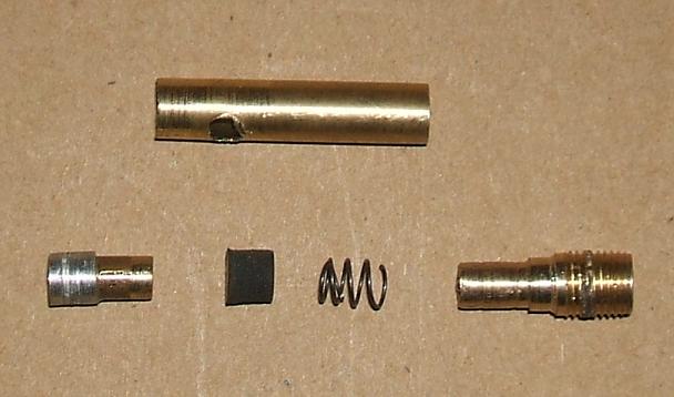

Well, I've decided to make it. Still bothered by the limited flow concerns mentioned previously but we'll see, I might make a 3mm semi-auto pistol :)
Here's the bits before I epoxy them together, it's basically a very short pengun with a spring behind the piston and holes in the chamber :roll:

I would see it working as a semi auto looking something like this, but not as an automatic unless you find a way for the trigger to be pressed automatically, because it lacks the "stepped piston" element which makes pop-off autos work.

Such a mechanical pilot design will not work unless you seal using an o-ring and seal in the porting.
The mechanical pilot design features no force to press the piston against the porting, which is needed for it to seal.

But there is force, a pressurized air bumper behind it. Which will be pressurized.
And I thought I would have to do the o ring seal of some sort- thanks

psycix wrote:The mechanical pilot design features no force to press the piston against the porting, which is needed for it to seal.
In my 10mm piston launcher linked to earlier the rubber of the piston was compressed against the seat and held under compression by the trigger, but it was only good to 80 psi or so, obviously your modification works much better - though you need a lathe to be sure of having a perfectly centred piston.

Don't forget that air in the chamber must not be allowed to enter the pilot. Or the pilot must not be air-tight.
The later will waste air, and preventing it means just one more o-ring.
