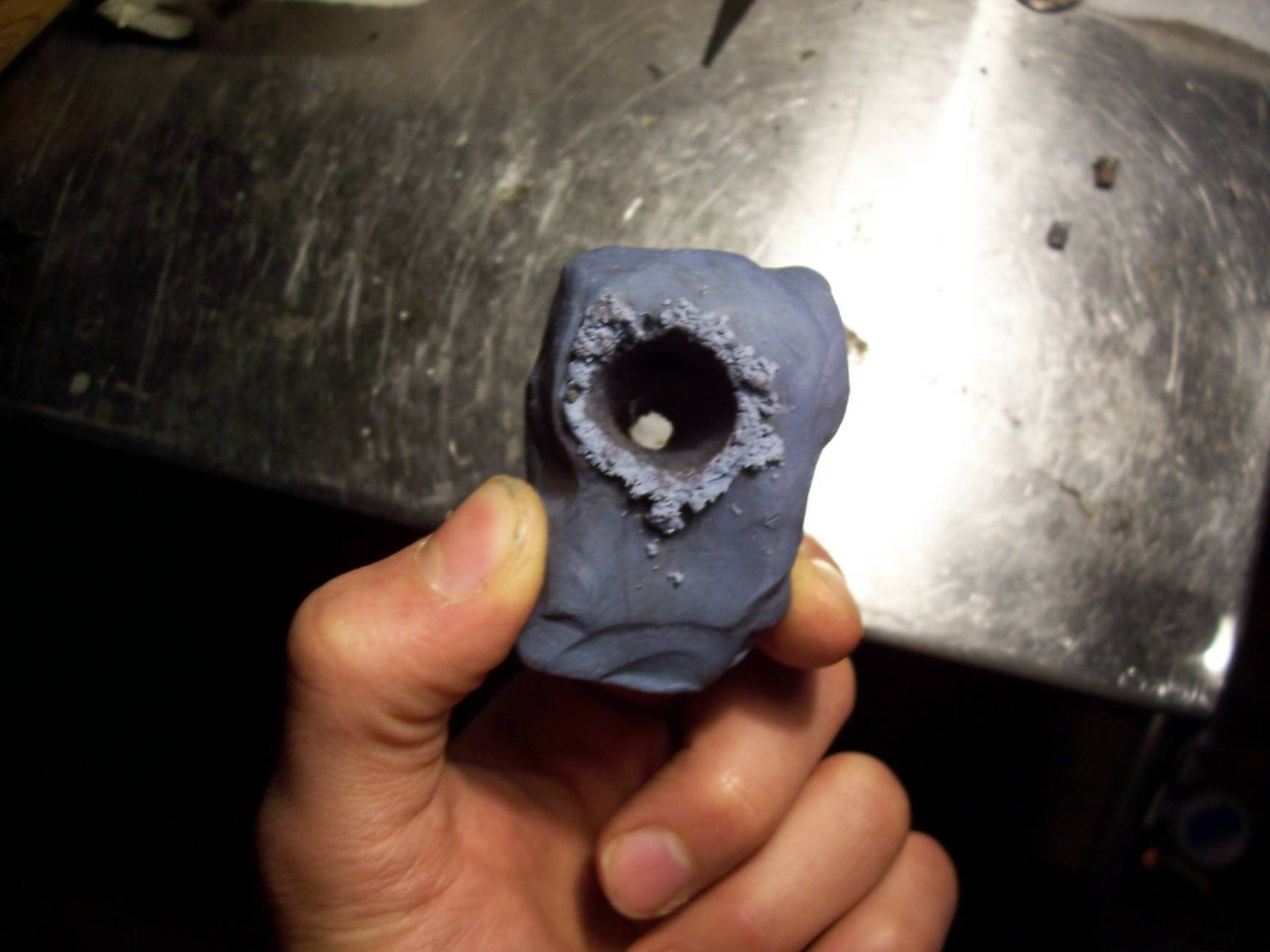

The first shot was a soda can full of water at 270joules with the lead slug, the next shot was a lead slug with one slit cut in it like a dum-dum bullet into clay at 370joules. I lined up four pennies and the dart went into two of them and then curled back into the second penny and skewered them together.
