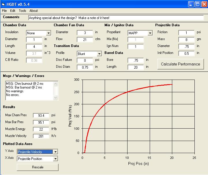

EDIT: Hmm... played with GGDT a bit to mock up a combustion cartridge...
may have to give this a go as I have all the stuff I would really need

Looking at your HGDT data, looks like a 3/4" marble gun? And if it's cartridges, are you going to have a fan in each one :shock:
As discussedhere, a revolver cannon would probably be easier to make than one would think, especially if it's a combustion.

yeah well thats for BBs... I was thinking about launching something a lot beefier :D
I'm not so experienced with combustion cannons anyways but I think I know how I'm gonna make these cartridges.
