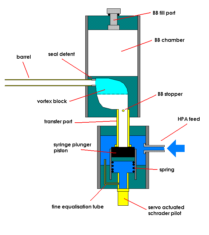

Well, technically then this isn't double posting :D Here's vaguely what I had in mind for the "gun" portion of this project, basically what I was trying to do here (but using an airtight piston made from a syringe plunger so I can have a separate equalisation hole of predicatable flow) coupled to a vortex block BB chamber.

why not a solenoid valve?
It would be difficult to get a servo to push a schrader reliably. If your looking for lower flow, there are valves like these:
http://www.legoeducation.us/store/detai ... =0&t=0&l=0
Its used for lego pneumatics, that would be easier to actuate.
I have a couple, they work great.
If you put a little silicone grease in it and work them, the become very easy to move.
Wed Feb 03, 2010 1:07 am
stuff from lego pneumatics operates at a couple of bars max... he wants to use hpa...
but I agree that a solenoid valve could be used here
lol I just realized that jsr is responsible for some of the most spectacular fails around here and now he is building an autonomous turret.. heh.. what could possible go wrong?? :D
Wed Feb 03, 2010 1:11 am
rp181 wrote:why not a solenoid valve?
I imagine it's hard to find one rated for the pressures I plan on using
... but would they take 800 psi? I think I will look into lego pneumatics anyway, they seem to offer quite a few interesting options for lower pressure projects...
I don't see why it would be difficult for a 6kg/cm servo to open a shrader, if it doesn't manage to open it directly you could always have the schrader operating a double action spring loaded trigger, though this would not allow full auto fire.
