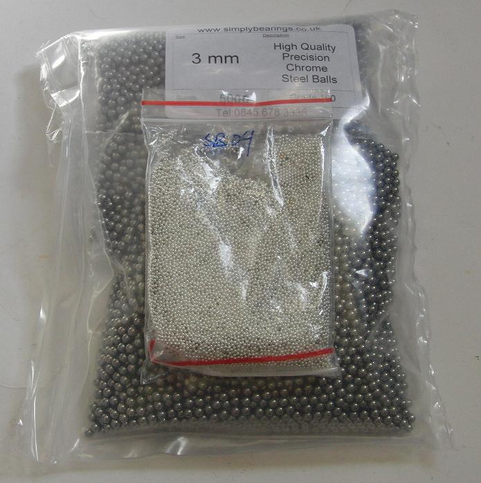

A small aside, to give an idea of scale this is what over 20,000 1mm BBs look like comapred to 10,000 3mm BBs:

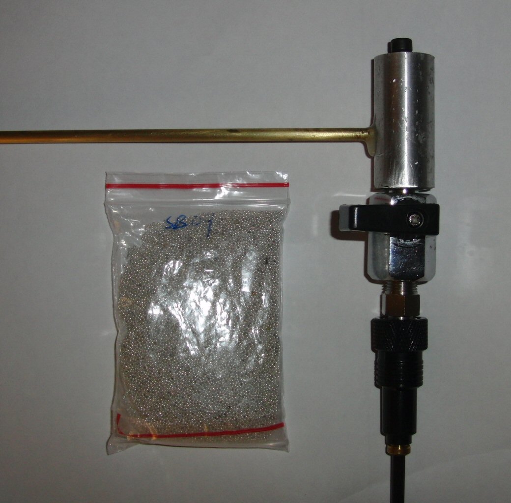

Bit of an update, Prototype No.2 - conventional vortex block strafer type this time as per original concept- curing as we speak, to be tested within the next few days.
Edit: see some initial testing >>here<< :D
Here it is mocked up with the ammunition for comparison, all up weight so far is 110 grams but it still needs the trigger servo
