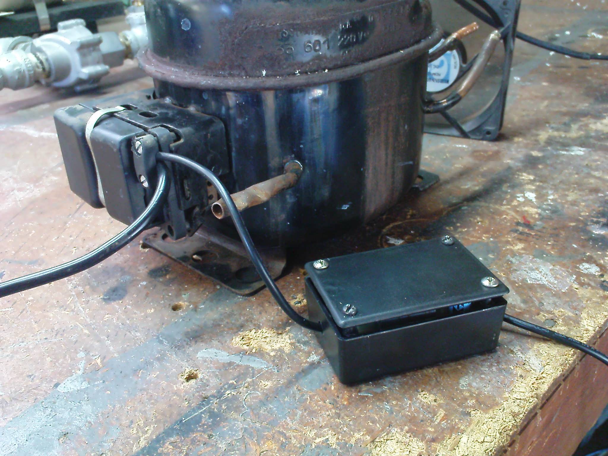

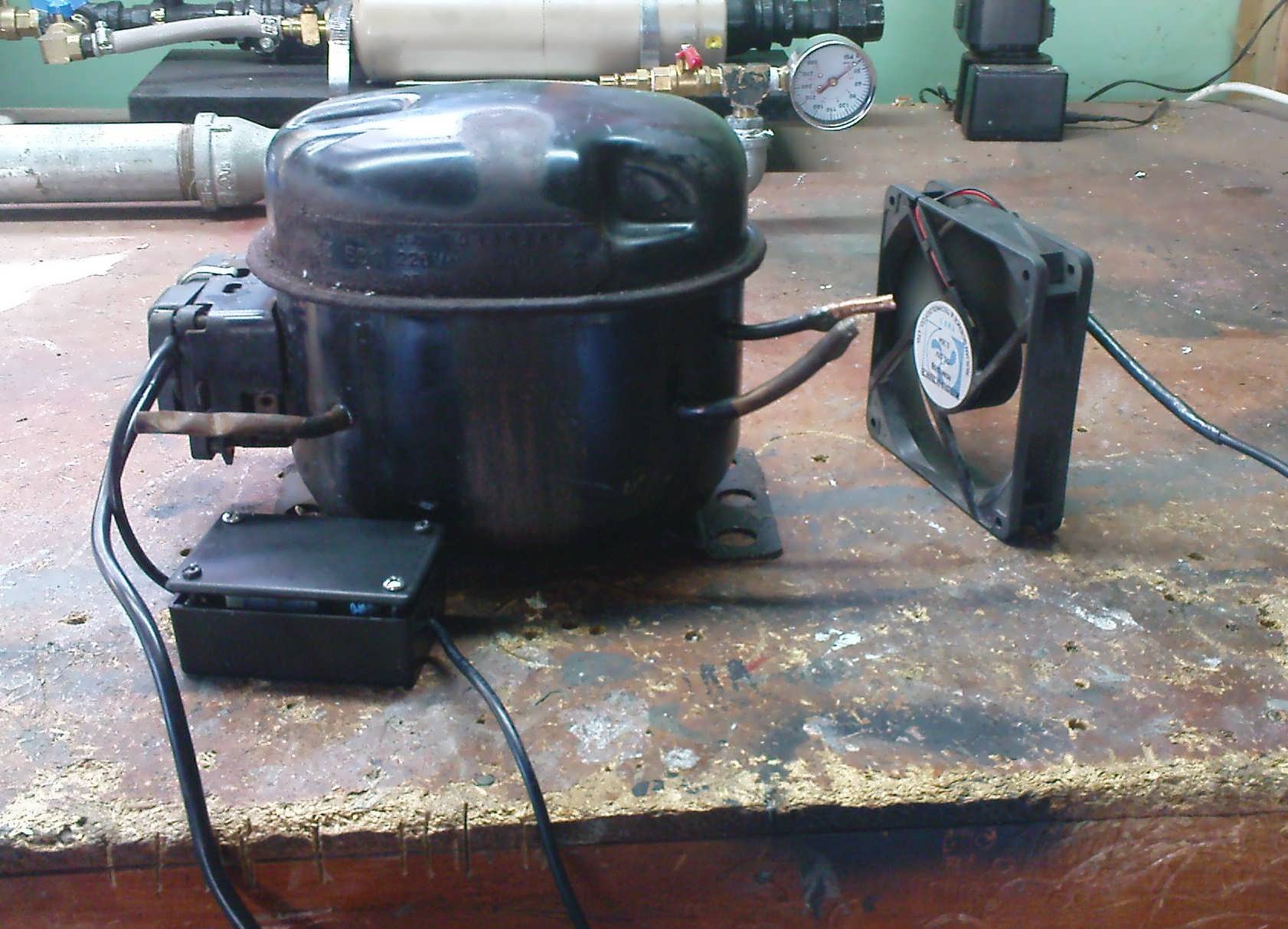

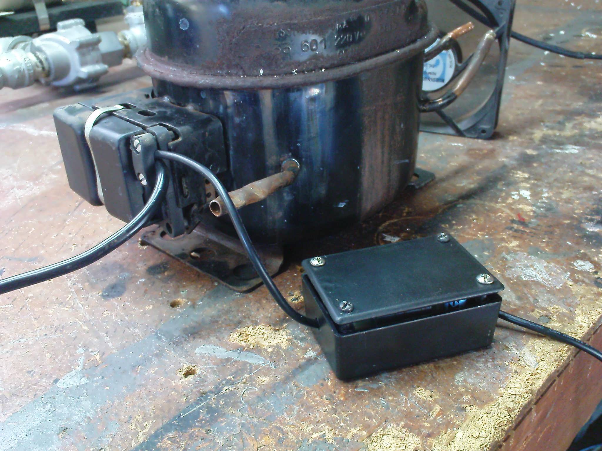

Took about 15min for my compressor to get hot, doesn't look like there's a way to mount the heatsink effectively either. Only fan I have is rated for 12v, perhaps I can find a phone charger or something so I can make the fan run off mains power. I've also ben thinking about an enclosure for it as I would think a fan would be fairly inefficient if I strapped it to the compressor like with c11man's.
edit:
Wired some adapter that dropped voltage to 12v and current to .5 amps to the 120mm fan. Works surprisingly well. Left the fan and fridge compressor on for an hour and the compressor was only warm. You were right POLAND haha.

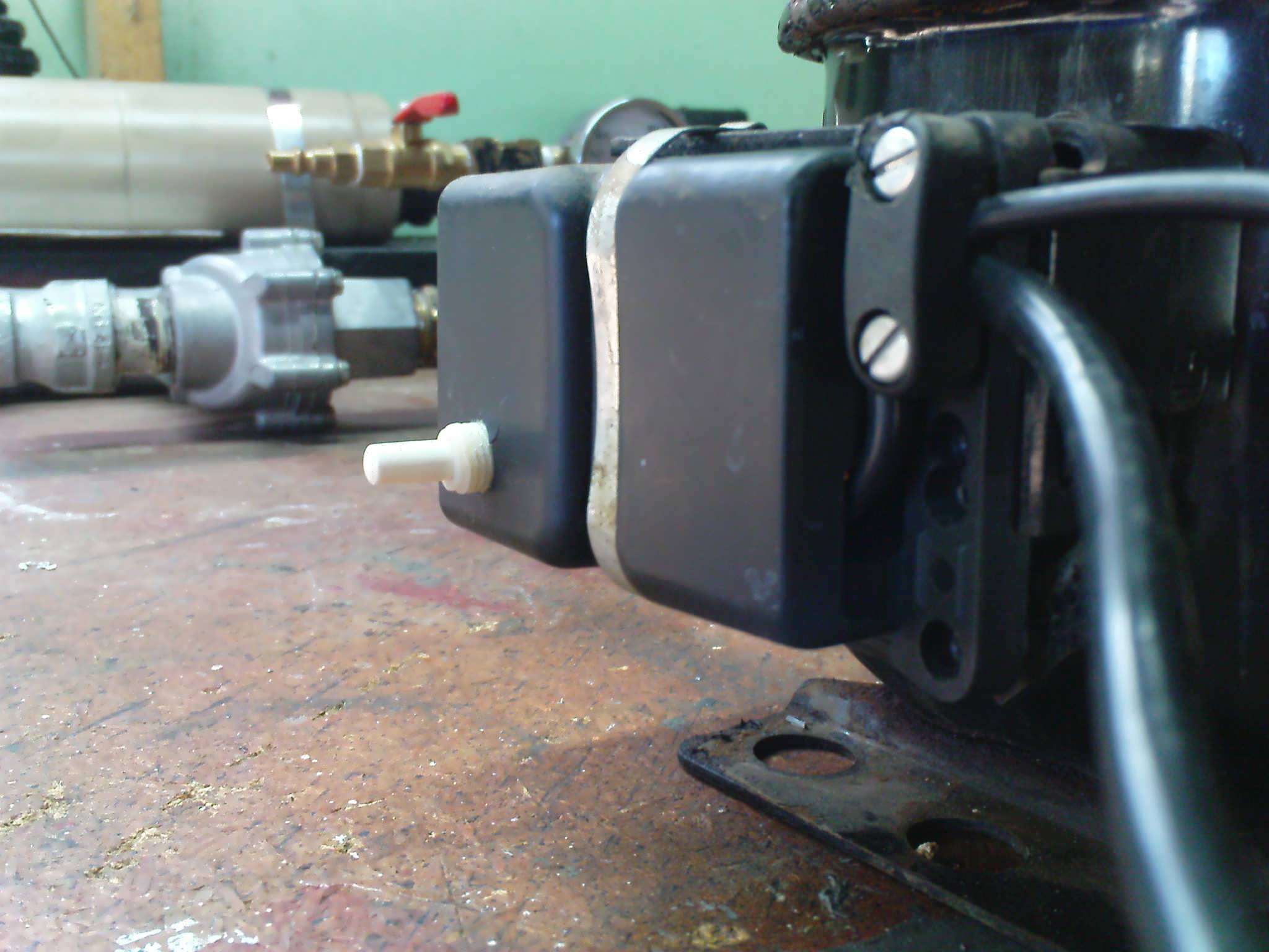

edit: Today I took apart the cellphone charger/transformer put it in a project box and wired it to the fridge compressor so now the fan not only runs of the mains but uses the same plug/cord as the fridge compressor. Before I had it wired separately.
Tomorrow i'll look for a mains switch that can handle 240v so I don't have to turn off the fridge compressor at the wall and I'll look for some sort of enclosure for it. I wont get to buy any hoses/compression fittings until Friday.
Wed Mar 17, 2010 8:31 pm
Added a switch. Here are some photos...
