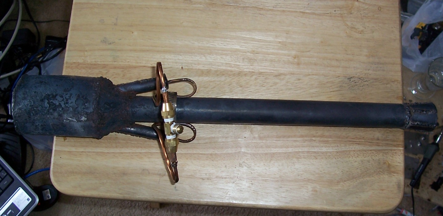

I got hooked on pulsejets, about a year ago and proceeded to build 5 of them, but stopped around August, of last year... Warm weather comin' aorund, the bug bit me, again.
I made a cheesy/generic webpage of the engine, showing most of the details. The webpage includes a couple of links to videos, which are posted on youtube.
<a href="http://sites.google.com/site/drspulsejets/" target="_blank">DR's Pulsejets</a>

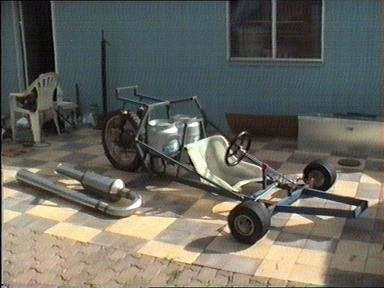

I made one many years ago, in fact while I was away at university I made the <a href="http://www.spudfiles.com/forums/brass-h ... l">harpoon gun</a> the first year and the pulsejet the second, something to fill in my time that judging by my grades would have been better spent studying.
Though unlike the gun this engine never worked! I got way ahead of myself building the trike before seeing if it even worked, it was designed to fit two of them. Though I never really tried to tweak it, the engine dimensions themselves should work as its based off the original lockwood hiller patent, thinking the fuel nozzel was at fault.
- jettrike.jpg (36.08 KiB) Viewed 5774 times

That's an AWESOME-looking trike design! Too bad those components weren't sitting in my garage, as I'd have it screaming down the street, by tomorrow!- Ha!
I've seen a LOT of videos on youtube, with people having a LOT of problems, getting their lockwood-hiller to start... It's ALL in the injector, as you've implied.

245 Tommy,
I made one similar to yours, with a piece of 3" Exhaust Tubing. The intake tubes are 1/2" EMT, and the Tailpipe is 1" EMT.
The front and rear of the combustion chamber is dome-shaped, as I used two stainless steel soup ladles, for the parts.
<a href="" target="_blank">Homemade small Thermojet</a>
...There's a tutorial, at the end of the video.
