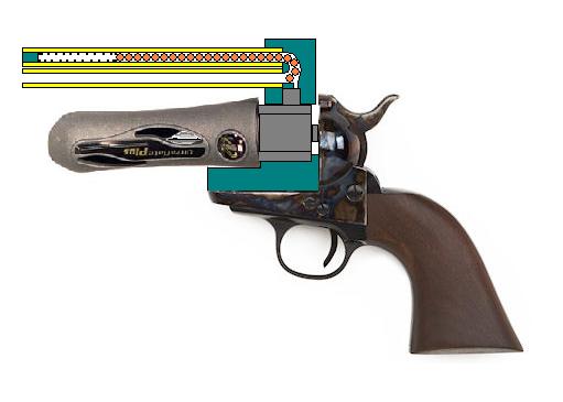

It will if you have a double action trigger. Can you get a revolver cap gun? If so you could conceivably cut it up and have it hammering on the inflator stem (the part under the trigger that I'm holding above), that will give you a burst of gas per trigger pull that would work great with a tee magazine. It would probably not be that pretty, but it would workit wont be semi auto with a hammer valve either

Here's how it looks like in my head:django wrote:Ive got an old 357 Blank gun( metal), might be able to use it?,I'll try get a pic up 8)

In the first diagram you can see a barrel, and a tube that holds the BBs.

- Joined: Fri Jan 02, 2009 6:10 pm
