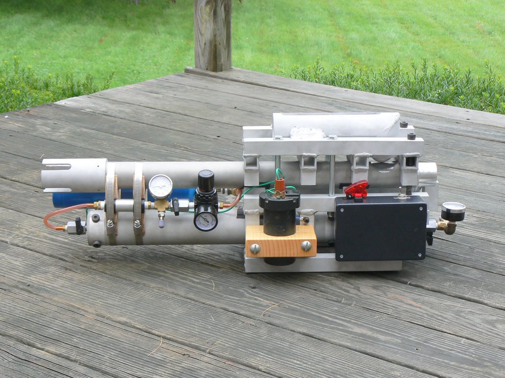

This project started in January with this design, but I improved upon it after realizing that welding the chamber would significantly weaken the chamber.
I then came up with the design below, which skirts the issue of welds by using bolted connections, as advised by Moonbogg. This design was made possible because I had access to a full machine shop (lathe, milling machine, etc.). To achieve a seal, o-ring grooves were machined in 6061 Aluminum plugs. I also machined a UHMW piston with an o-ring groove, as the design features a chamber-sealing piston.
I machined a bolt out of aluminum to allow for fast and easy reloading. The bolt has an o-ring to seal. On top of the launcher is a sch. 80 aluminum pipe which serves as a magazine. The balls are loaded into the magazine and then drop down into the barrel when the bolt is cycled. The magazine features a milled slot, allowing me to check the number of balls in the magazine.
To hold the chamber and barrel together, I made a frame out of square aluminum tubing and TIG welded it together. I then sandblasted the frame and the chamber and the barrel.
Ignition is achieved with a camera flash capacitor dumped through an ignition coil. I also made a remote-firing device with an RC car controller, an RC car receiver, and a relay.
For aesthetics, I added a flash suppressor machined out of sch. 80 aluminum pipe with slits cut with a milling machine. Its held in place with four set screws.
Specifications
Chamber: 14" of 2" I.D. 2.5" O.D. 6061 T-6 Aluminum Seamless Tubing
Barrel: 19" of Sch. 10, 1.5" Stainless Steel pipe
Valve: .75" porting chamber-sealing piston valve
Ignition: Camera flash circuit dumped through ignition coil with remote ignition system
Mixes: up to 8x, but mixes up to 15x should be possible.
I haven't fired it yet, but I will in the next week.

This is a super unique design and I love it. Bombass job! May I bring something to your attention? I notice you have 4 bolts holding the end caps to the chamber in a shear configuration. Calculate the maximum force on those end caps, then divide it by four and make sure the shear strength of the bolts you use will be strong enough. Also, make sure the holes where the bolts go through the chamber don't see enough force to stretch, deform or crack the aluminum around the hole area. I considered holding end caps on this way, and I would suggest at least thinking about adding another 4 holes for a total of 8 per bolt pattern. This lessens the stress on each hole area. There is a lot of force on each of those small frontal hole regions, so dividing it up between more holes may be better. I will run a stress analysis for you if it would help.

Moonbogg, thanks for the concern, but before building it, I calculated the shear strengths needed and I can say that at normal operation I have a safety factor of 13. I didn't just go to the hardware store and pick out some $0.89 bolts. I did my research and ordered proper shoulder bolts. That being said, I will be sure to check the launcher periodically for any cracking or stretching of the aluminum tubing.
