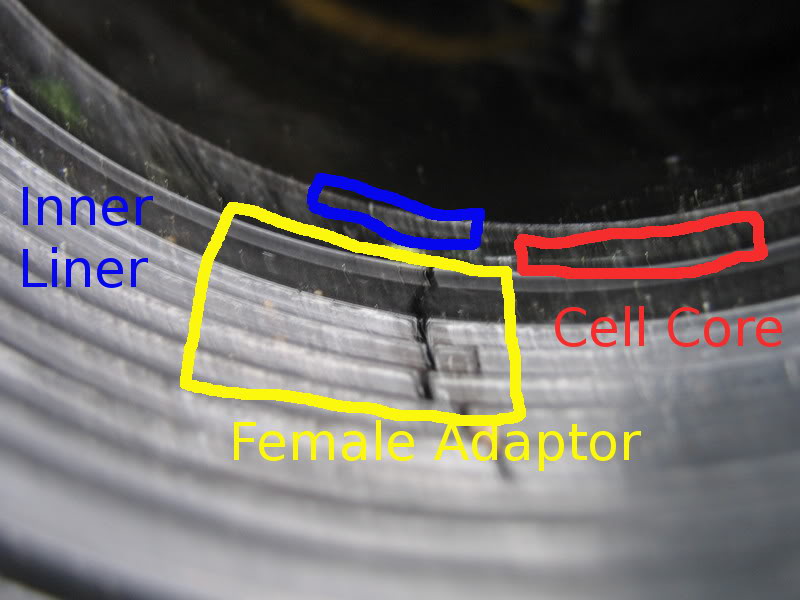

Thu Jul 01, 2010 3:38 pm
Do you have a photo of the label on that pipe? I have used both Cellular Core ABS and solid ABS. Solid does not have the 3 layer construction. Two layers of the pipe are showing in the photo. That pipe is Cell Core.
BRB.. I'll grab a photo of the end of a piece of Cell core for comparison.
This Oxygen enhanced Spray-N-Pray is Cellular core. All fittings are DWV. Enjoy. This video was found after I built my ABS cannon. This video is why I tested to 100 PSI this year for the first time.
Layers of Cellular core are showing
ABS co-extruded pipe. It contains 2 solid layers with a bubbly layer in-between.  The bubble size varies between manufactures.  I have seen the stuff with very foamy size bubbles. The tiny bubble stuff has a gray appearance like the photo above shows.
