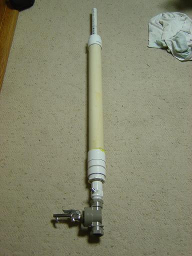

This is my first Barrel Sealing Coaxial Piston Cannon I have created and i think that I actually had more fun building it than I do firing it. It is very very powwerful for how small it is. The chamber is 2'' and the barrel is 3/4'' and the piston is made from a 1-1/4'' coupler. To relieve the pilot i have used a modded sprinkler valve. The pictures explain it all and any design suggestions or ideas would be greatly appreciated.
http://media.putfile.com/My-Spudgun -----> The Video!
Overall shot of gun...

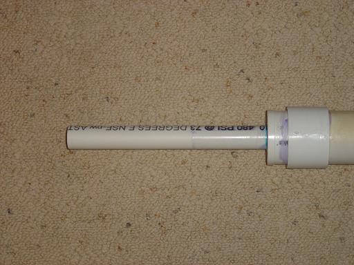

A shot of the barrel and chamber alignment... I worked hard to get the barrel straight without alignment fins of any sort lol...

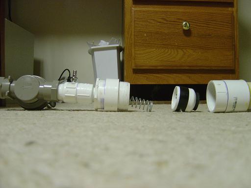

Inside of gun sectioned out with old piston...

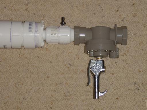

Bottom of barrel and chamber with valve...
Top of barrel and chamber...

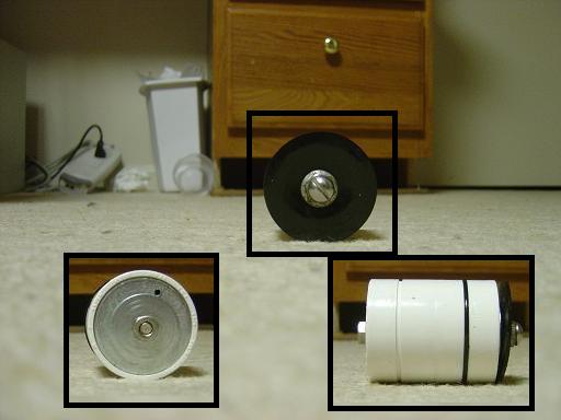

My old piston which sealed with electrical tape...
My new piston with O-ring (Slot machined on lathe)...

Why did you put o rings on the piston? Its no a chamber sealing valve.
But that is a very cool piston cannon, post some damage pics :D
Join the spudshot forum!!!!!
Thu Aug 10, 2006 3:09 am
Yeah i thought i saw o-rings on there somewhere.How did you cut the groove for them?
Benny
Posts: 844
Thu Aug 10, 2006 3:26 am
Put the endcap in the lathe and fire away.

Nice cannon though. I like the fact that you used an O-ring on the piston. That gives it much more reliable equalization that you can control by choosing the size of the equalization port. Too bad I still haven't found anybody who can do O-ring grooves for me yet.

Yea I own a Jet Mini Lathe and I use a chuck on it that tightens around the coupler used for the piston and cuts ideal o-ring grooves. As for the PVC being old it is only about 3 months old so i put my full trust into it. It somehow became discolored. I used an O-ring on it because it slides better and i just created an equalization hole for air to fill the chamber. I do however need help with the seal. I am using a neoprene washer and it slowly leaks into the barrel???
