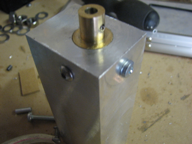

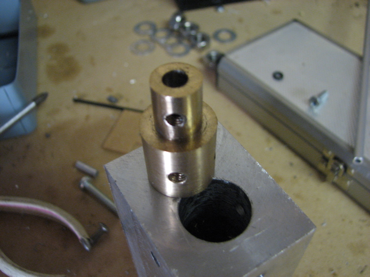

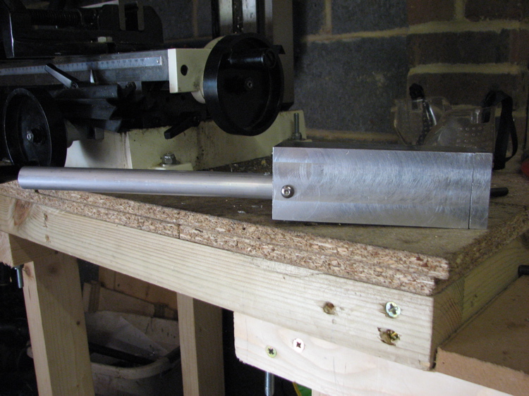

Pressure vessel attached

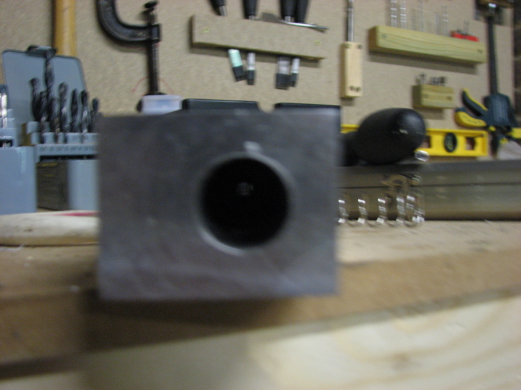

The massive hole bored in the block of Ali runs the whole way through.
These bolts hold it in place.
Tis connects the pressure vessel to the main body.

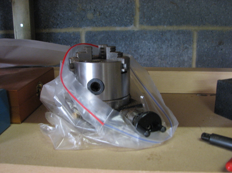

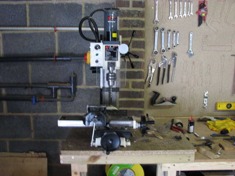

A Rotary Table, for making round things.
Yay for Milling machines! Also, you can see the ends of some less interesting cannons

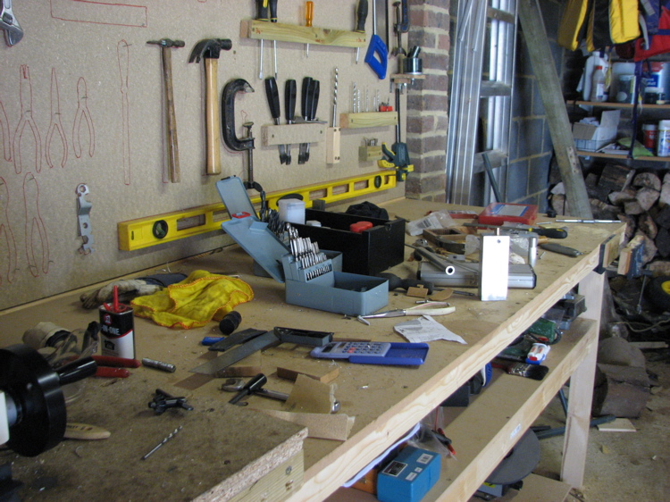

Always good to keep a tidy bench.

Wow I didn't know anything about rotary tables until I saw this post. That looks like an extremely useful accessory to a milling machine. Excellent work, and good for you having a setup like that. You make most of use jealous. :lol:

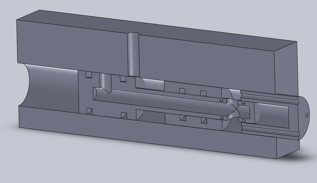

OK, so I've done some math.
I was planning a hammer valve, but unfortunately I just figured out that if the valve stem had a radius of 3mm, (Diam=6mm) then a pressure of 400psi (0.28123 kg/mm2) would exert 7.95kg.
To clarify; 0.2812 (3^2 pi) = ~8kg
8kg is too much force for as small a hammer as I had planned, I think, and a bigger one isn't an option.
The goal is to have a small repeating valve (one pull of the trigger does not discharge the whole tank, cock, fire again etc.)
To that aim I did some modeling of another possible valve design, but I am not sure how well I can make internal O-ring grooves. If anyone has had any experience making them, I'd really like to know how it went.
Has anyone made a valve like this before? Any comments and ideas are welcome, this is certainly not final.

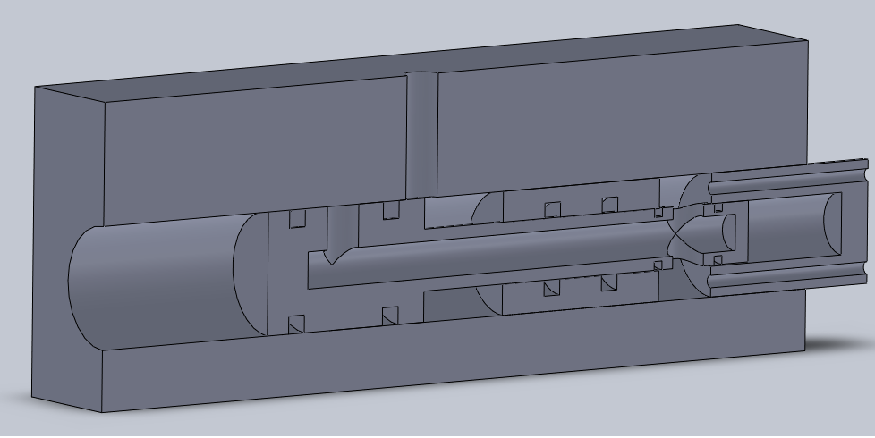

The stem/bolt of the valve, filled with air is now pushed forward, closing the hole allowing air in, and opening the the hole to the valve.

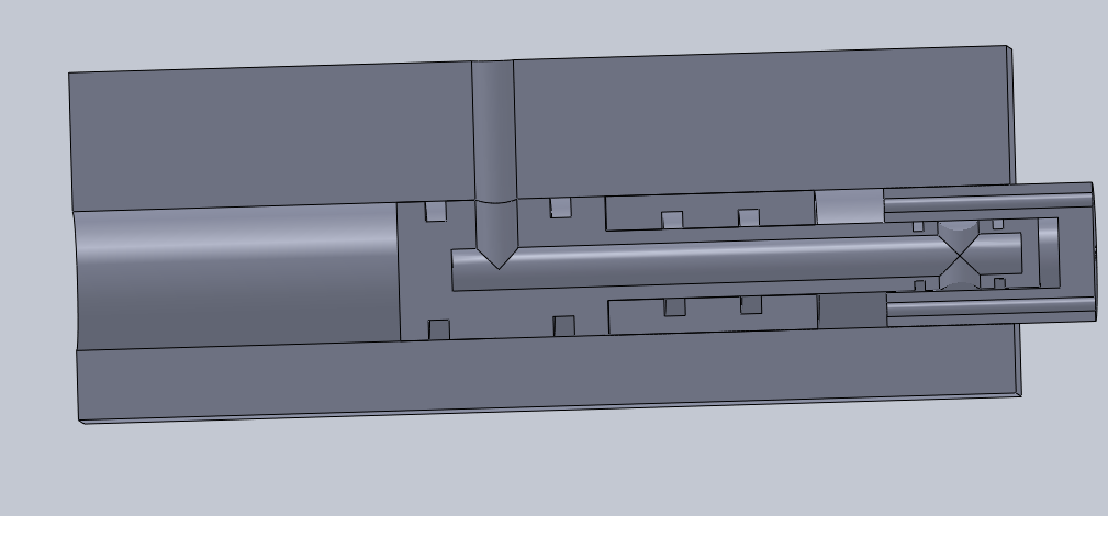

Air at 400psi comes int through the small holes at the front. It fills the inside of the valve stem/bolt, the bit in the middle.
The new valve
The new valve

Here's the part I think will cause me difficulty in terms of getting it to seal
Will this sort of thing seal reliably?
