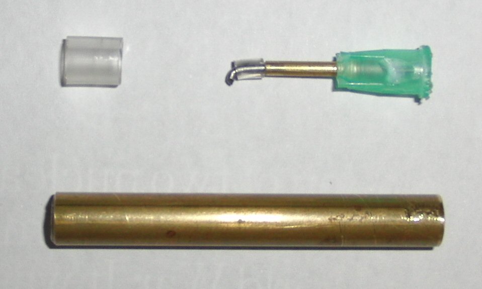

Anyways, prototyping time :)
edit: I made 2 cartridges, one with a separate fill valve and one that is filled through the breech. These are the internals of the former one, I'm not sure if it will seal with this system so I may have to try with a pin/nail and small o-rings of the sort one would find in lighter mechanisms:
