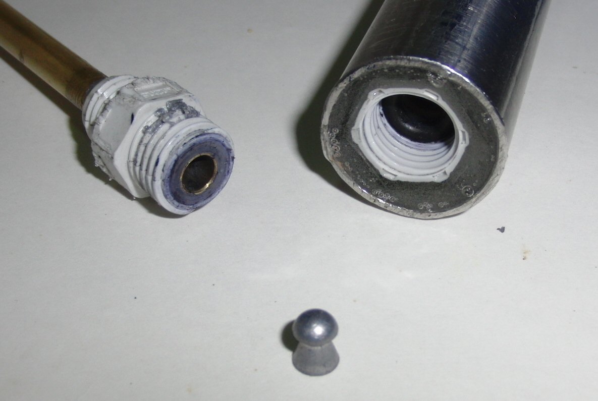

This was at 6x using photo paper as a burst disk. I can't get it to ignite any higher with piezo ignition, I might have made the spark gap a little too wide.
Also sometimes the disk doesn't burst, the chamber gets very hot and when you open the schrader an amusing whiff of smoke comes out. As you can see the chamber is now much more substantial and will happily take the pressure, unlike my previous effort.
Ammunition is a 0.22" airgun pellet (barrel is 5.5mm I/D brass tube), I didn't chrony it but to be honest muzzle energy isn't that impressive - however as someone accustomed to HPA launchers I'm not easily impressed :roll: a pellet at 6x made a big dent in 0.6mm steel sheet but did not penetrate. My PCPs firing the same pellet at 850-900 fps will happily punch through the same target.
detail of the breech and ammunition.  The threaded portion is taken from an electrical connector set in epoxy, note the chamber wall thickness.
what you are waiting for... go for 10X mix :D
MOAR is a good thing[/quote]
Has thanked: 581 times
Mon Sep 06, 2010 2:24 pm
POLAND_SPUD wrote:what you are waiting for... go for 10X mix :D
It usually is, but in this case MOAR than 6x isn't igniting...

hit a small dent just at the end of epoxy so the spark gap will be little smaller :D
CpTn_lAw
Posts: 987
Location: France
Mon Sep 06, 2010 3:01 pm
Yeah I'd follow that advice... spark grap really needs to be small.
