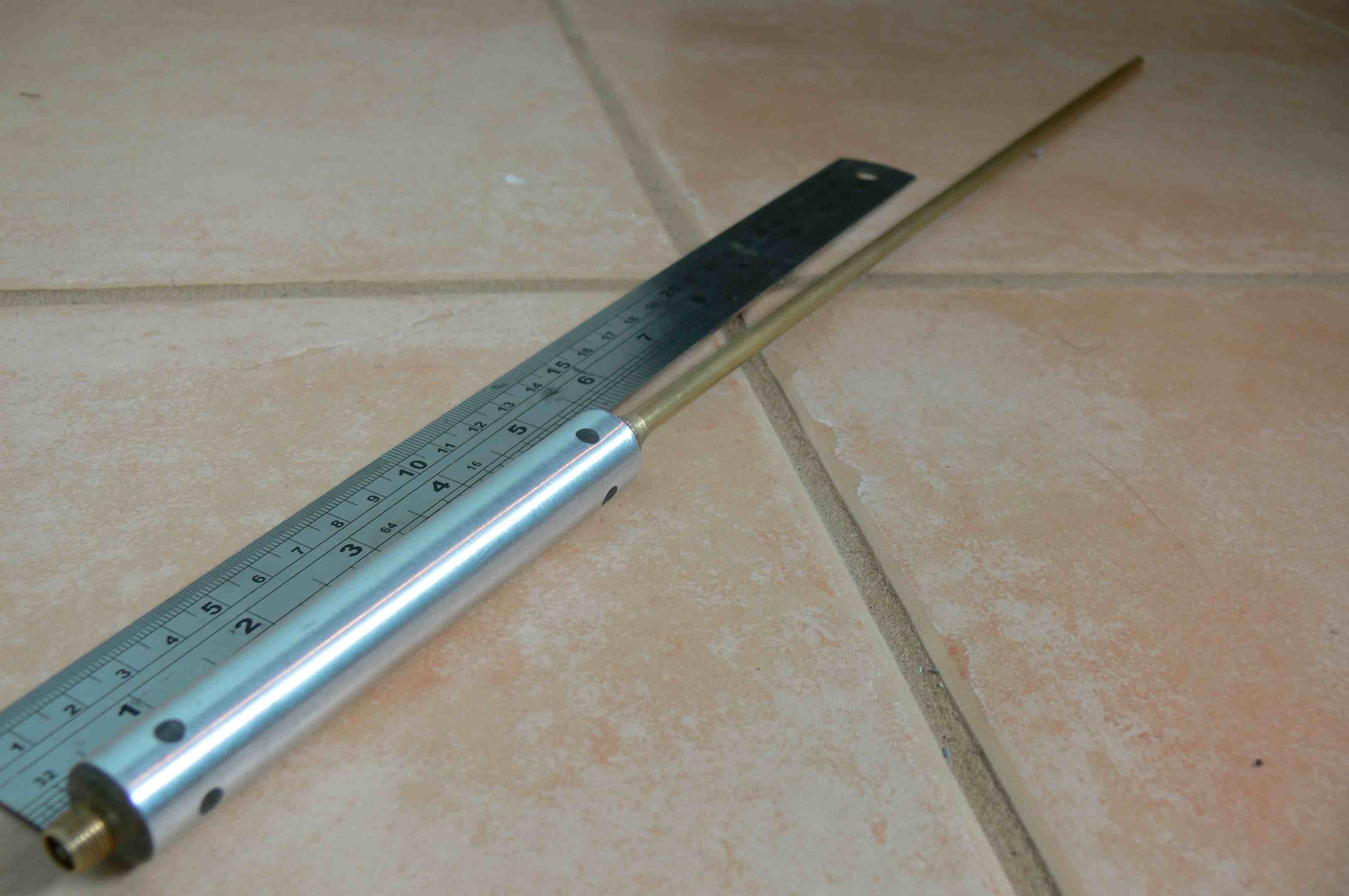

Very cool JSR, congrats on getting it working! are you worried about that plastic electrical connector failing or cracking though?

just remember to hit it with smooth korner like table, then it wouldnt weaken the chamber much
Mon Sep 06, 2010 3:34 pm
Wow, this is unlike anything you've built before; it actually works and you used PVC :D
Just kidding, I actually really like it. A 6x mix is pretty impressive too, I thought you'd have fueling trouble at anything about 2x or 3x really. What would performance be like with a longer barrel? But I 'spose the barrel is scaled to the cannons miniture size.

JDP12 wrote:are you worried about that plastic electrical connector failing or cracking though?
It took a 6x mix without the disk bursting several times and doesn't look any worse for wear, I think it can take the strain. I've used similar connectors in HPA applications (such as my rattlesnake V3) and never had a failure of the threaded section.

What would performance be like with a longer barrel? But I 'spose the barrel is scaled to the cannons miniature size.
Really, the barrel is oversized for the pistol-type project this was destined for, so upping the mix is the way to go.
In that regard, I might be able to bend the electrode a little further towards the schrader in order to reduce the spark cap and get better ignition at higher mixes.

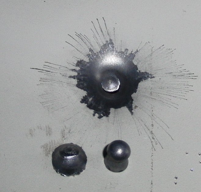

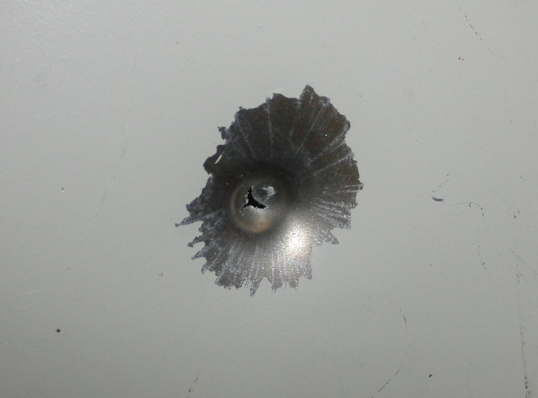

A but of judicious hammering later, managed to shorten the spark gap, it's now happily igniting at 8x, with that a 0.22 almost made it through the 0.6mm steel plate :)

0.6mm steel target shot at 8x filmed at 420 fps, just barely didn't penetrate:

Tue Sep 07, 2010 11:48 am
Let's see if it objects to ignition at 9x ;)
edit! woohoo! first click piezo ignition at 9x (6.3mL butane/propane, chamber pressure 135 psi) and it's probably only a few fps from penetrating the steel. Lovely splash from the lead fragments though, I also put in the "before" and "after" 0.22 pellets. With a steel projectile I have no doubt it would have penetrated.
No more time for testing this afternoon, but I'll definitely keep adding x to push the limit of what piezo ignition can achieve...
