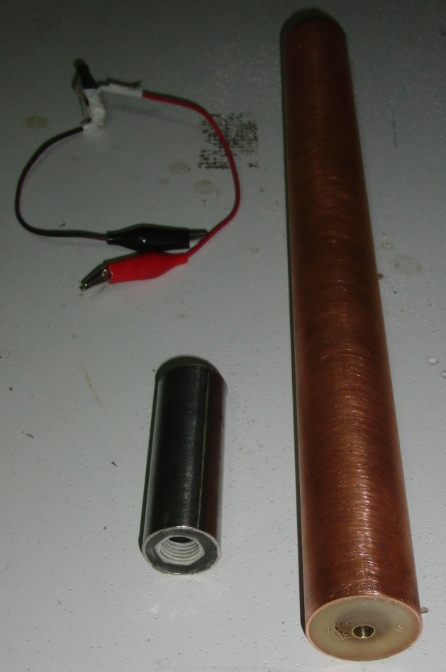

Here's the (roughly sanded) suppressor, chamber and ignitor setup:

Haha that's awesome, love how much larger the suppressor is than chamber

Now this is getting nice!
The suppressor looks very good and the chamber is realistically pistol sized. I think I will convert my mini piston pneumatic into a hybrid now :P
Your design could be extremely nice if stock mounted! However, the only thing I see wrong is that you will (probably) be holding that hybrid right ahead of your eye with a epoxy end plug..
