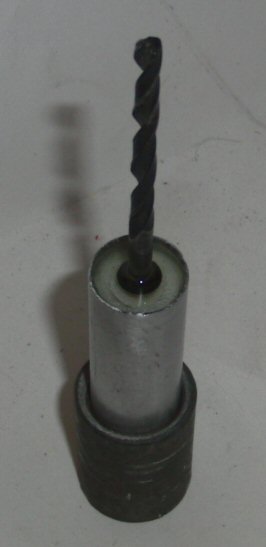

Experience is a harsh mistress. I started using epoxy for spudding purposes 12 years ago ( :shock: ) and I remember the frustration in beginning when frequently a carefully made coaxial is lost forever as epoxy from the rear endcap leaks into the pilot area :roll: but you learn your lessons pretty quickly.
This is how the current one is curing, I'm using a 4.5mm drill bit wiped with grease as a mandrel.

Cured beautifully :) it pops very consistently at 50 psi, which means it's only good for 4x, which means it's useless, but yay o-rings!
The problem in this case is that although the o-ring has a 3mm I/D, since I cast it with a 4.5mm mandrel through it the ring is held open by the epoxy so it lowers the pop-off pressure considerably.
