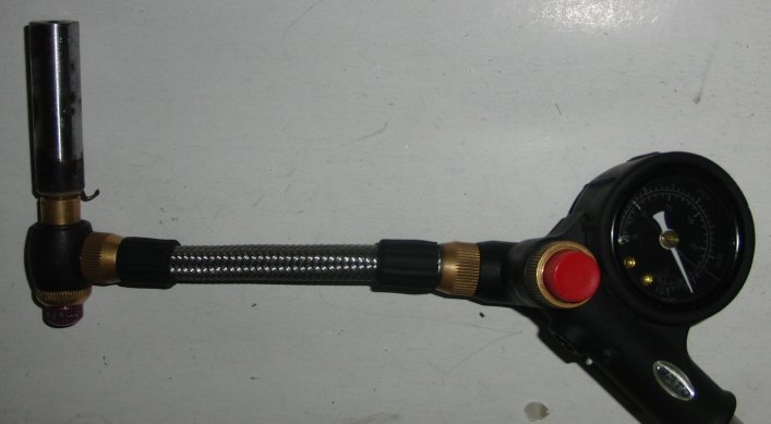

Still working on this project, while the 3/8" cartridge works well it's still too big and low mix for my liking, so I've drilled out the mouth of this prototype and fitted this type of seal.
If it doesn't work I have another variation in mind, basically the same seal but inverted (with the seal "cone" opening outward) that would change the grip on the projectile and therefore pop-off pressure depending on how far you pushed it into the seal on loading.
Update: The modified seal certainly held well, even hooked up to my paintball tank at 800 psi or so the BB didn't pop, though it stuck so much out that it looked like it was just about to, which sounds good for a 16x mix. For some reason though, the schrader filling valve failed on me so I was unable to try it as a hybrid. Still, inspired enough to make a new cartridge, keep watching this space :)
Tue Feb 01, 2011 12:14 pm
Following POLAND_SPUD's suggestion here that it might be possible to seal a hybrid without using a seal, simply by swaging a lead projectile into the breech.
I built a quick prototype looking like this internally:
Fitting a 4.5mm lead BB in a 4mm tube, it held 20 bar without leaking. I took it to 25 bar and it didn't appear to leak but over time lost pressure.
I went on to do some hybrid testing, unfortunately I seem to have made the spark gap a little too big for high mixes. The first shot is at 5x, worked perfectly, but at 20x the spark just arcs externally.
In any case, it works!
Over time, I'm sure the brass tubing would wear out and reduce pop-off pressure, but this could be compensated for by using a harder metal.
Another disadvantage is that forcing the projectile into the breech deforms it to the extent that accuracy will probably be dubious at best. I would be interesting to try with pellets instead of spherical shot.

The idea of a pellet would probably be better from several stand points.
More power due to surface area and also possibly may be able to add o-ring.
If you added more epoxy around the valve and the case lead, it may prevent the arcing. Any sharp points and the HV likes to travel to the point because it is more directional versus a circular ball shape.
Add as much epoxy as possible without interfering with the air inflation device.
