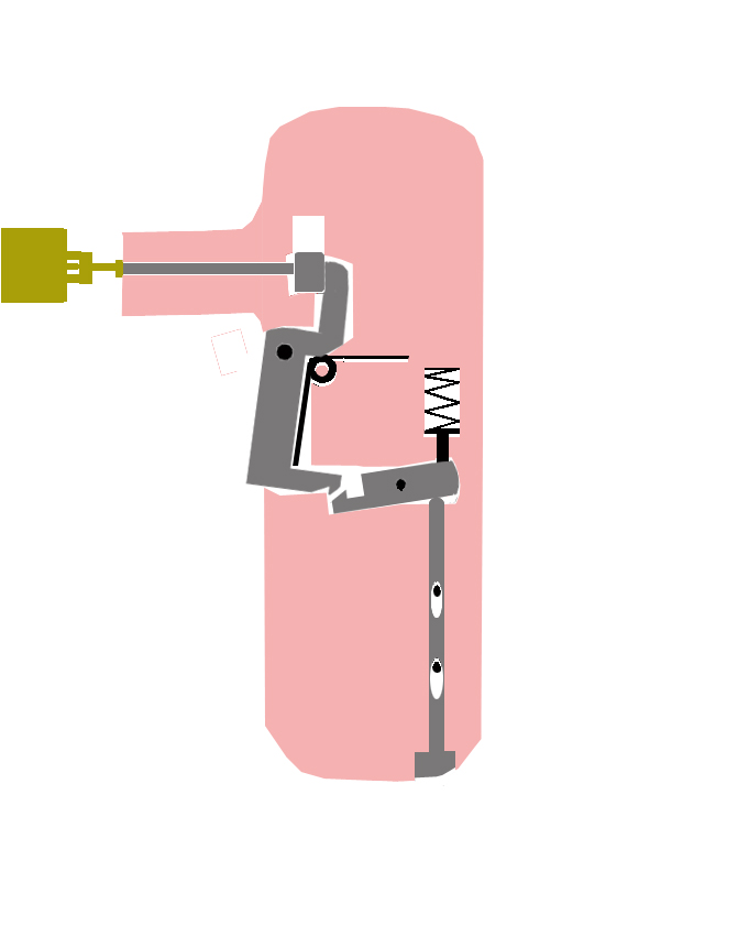

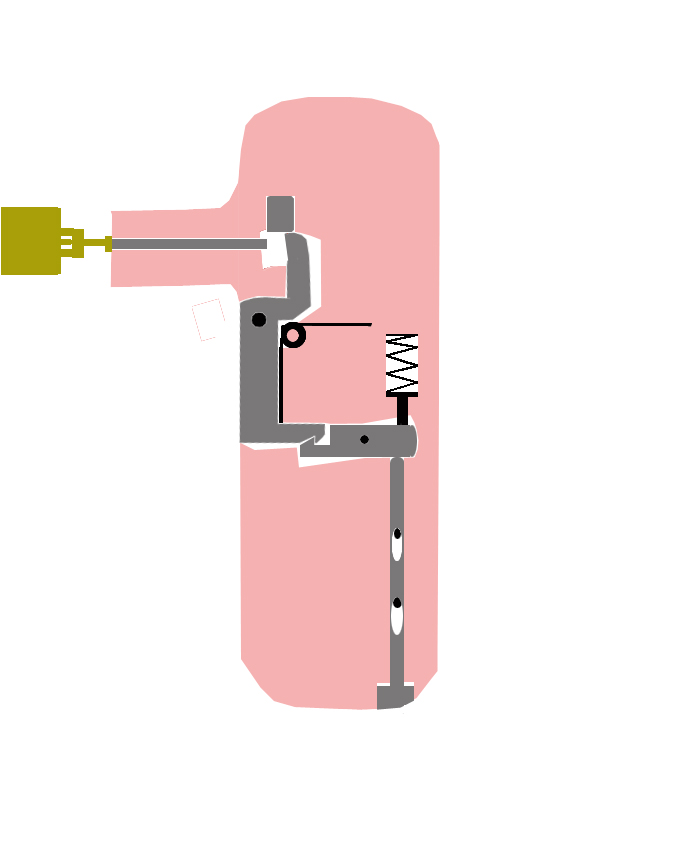

hey iv been thinking of making a secret cane gun and came up with this design for the trigger mechanism and would like to know it it would work or how i could improve it, all the pink and grey will be made out of sheet aluminum and hidden between wooden grips
what do you think?
push the button at the bottom and the trigger flicks out letting the square bit fall in front of the firing pin ready to be shot, if you then decide not to shoot the just invert it and press the trigger

Looks like it will work and it will be an interesting little project. On the other hand, you've done well with small hybrids, how about a hybrid cane gun :D

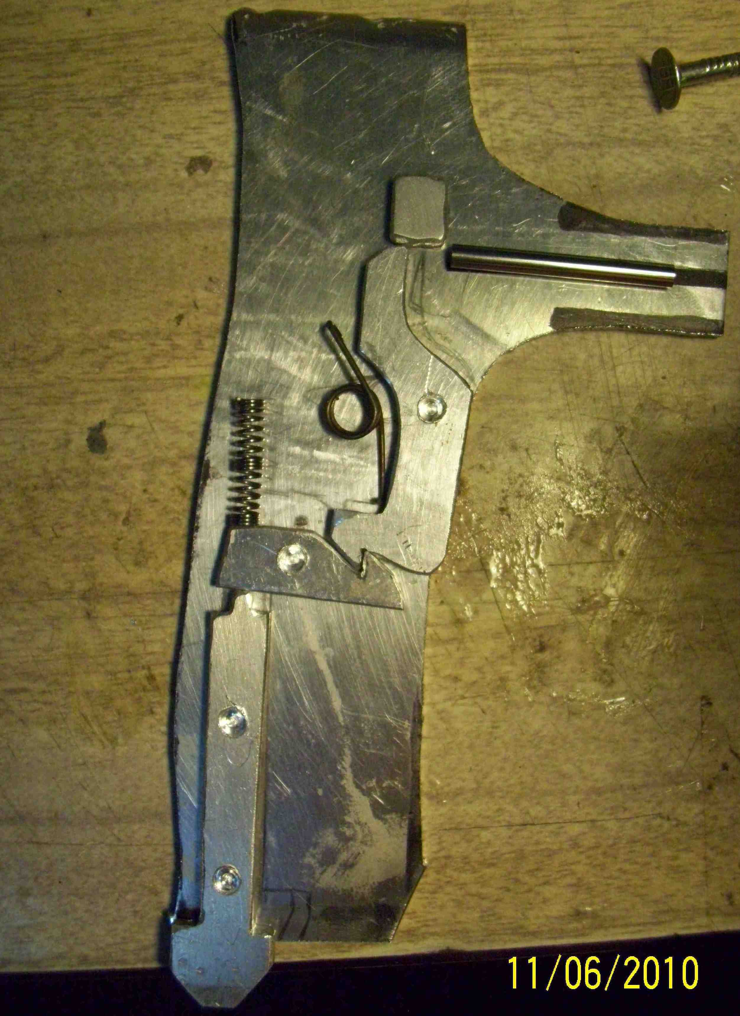

Sat Nov 06, 2010 4:39 am
update: got the workings of the handle almost finished

Sexy! What calibre/pressure will the final project be?

ilovefire wrote:update: got the workings of the handle almost finished
I was looking at that pic, and imagining how I would encase that in wood.
The thought occurred to me that those components could be smaller, and still be functional.
For instance, the pushbutton on the end of the handle: That function could be done with a metal rod, instead of a slab of metal.
Think, cutoff 1/4" x 6" bolt for the rod. Take the head off, or just file it into the 'button' shape. Then use as much of the plain shank as you need. Cutting off the remaining shank and threads.
I realize you'll need the 'belly' on the one piece, to be able to push in and reset the 'trigger'. But it seems to me that there is a lot of unneeded weight and size on most of those pieces, that could be gotten rid of.
I'm not being critical, and I hope I am not taken that way. I actually hope this is helpful.
What is the thickness of the metal ? Looks like maybe 1/4".
I'd leave the basic shape, the way it is, then cut "stocks" just like a handgun handle.
Then grind the metal and wood together, to get a good profile, with the metal showing.
I'd use the rod at the end, as I said, but with another difference.
Both rods could be done this way.
Drill a hole in the handle metal, and insert the rod through that hole.
If you stuck with rods, you'd have to use a rod smaller in diameter, than the thickness of the metal. But if you stuck with slabs, they could be just slightly thinner than the thickness of the metal plate. And run in cutout channels in the plate.

I am confused about one thing.
Is it your point to push in on a schraeder valve, with that rod ?
Or is the point, to release the schraeder valve ?
The way you have it set up now, you will be releasing the schraeder valve.
Meaning closing the valve, not opening it.
As-is, the schraeder valve will be held open until you push the button.
EDIT: Aha ! I just looked again.
You intend the block at the top to fall down.
Then you fire by pushing in on the "belly" of the one piece.
Clever.
Then I take it, you have to hold the 'trigger' in, and invert the cane handle to get the block to fall back out from in between the rod and the trigger.

That looks great!!!
How thick are the moving parts?

its all been cut from 3mm aluminum
Oxbreath, the reason i have the button made from the aluminum is so when its all put together it is not very obvious, infarct when i finish it and have it i a cutout of the aluminum plate i want it to be virtually invisible, it may make it a bit harder to press but that isnt necessarily a bad thing, also im not sure i know what you mean by "stocks", and thank you for your input i do really appreciate it

ilovefire wrote:its all been cut from 3mm aluminum
'Stocks' may be the wrong word for it. I'm not sure.
Think of the handle of a regulation pistol.
The handle of the gun starts as a piece of metal, like you have.
Depending on the gun, that metal will be a frame that includes working parts, and/or a magazine.
There are either two pieces of wood, or two pieces of rubber, or some composite, whatever... Bolted to this frame. One on either side. This completes the handle/grip.
Those two pieces of wood, are what I am calling stocks.
Aluminum is a good choice. I like working aluminum. You can use regular woodworking tools, for the most part.
Keeping the 'trigger' mostly hidden up inside the handle, is a good thing. I agree.
I think when you push the rod/button on the bottom and release the trigger, the trigger will become easy enough to push on.
Man. You have me wishing I was the one making this. LOL
I just may have to copy you, some day.
I have been thinking that the real weak spot in your mechanism is that block that you want to drop down between the trigger and the rod that will push in on the schraeder valve.
I don't think it is in your best interest, to let it just sit in there, loose.
How about this...
Set a rod in the top of it.
Run that rod to the top of the handle.
Put a cap on the handle, with another rod attached to it, which rod contacts the rod in the block.
Put a spring below the block.
Now, when you push down on the cap, the block gets pushed down.
IN the block, place another rod, horizontally.
When the block gets pushed down into place, that rod lines up with the rod that will push the schraeder valve.
Pull the trigger, the middle rod gets pushed. Which pushes the longer horizontal rod, against the schraeder valve.
Now, back to the anology of a hangun, as an example.
Think of the bottom button as the safety. I'll come back to that, in a minute.
The trigger is obvious.
The top button would be the cocking mechanism. Like pulling back on the hammer.
So, to fire.. You undo the safety. Cock the mechanism. Then pull the trigger.
The hammer and trigger, can still all be done with one hand.
The bottom mechanism could have a safety feature.
Like, you have to twist it first, to be able to push it in.
