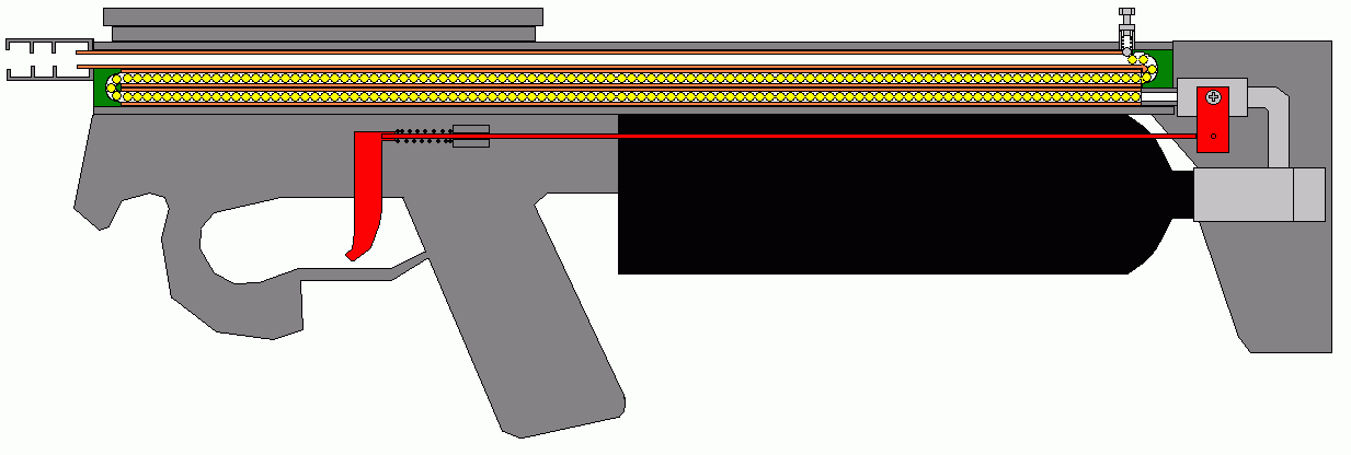

Can you see the flared ends? You can't really slide it up the tube... unless there's something I'm not getting.
Here's a fanciful idea of what I would have in mind as a finished project, something like the Magpul PDR:

The flared end of the bender has to be facing toward the staight side of the tube, not on the formed end.
I would make a drawing but it would take to much time.
If I had exact dimensions of benders and the radius of how tight the bender can be wound, I could create a real model.

No no you were right, they *are* meant to be used externally!
The problem now is that the largest one is for 3/16" O/D, and the pipe I wanted to use them for is 1/4" O/D :cry:
