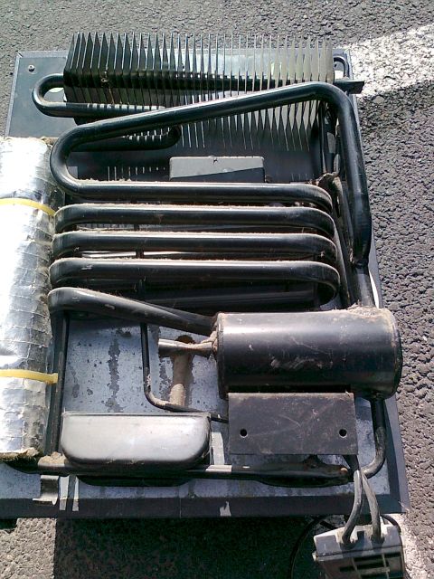

I Has Fridge Compressor But No Skillz
- Technician1002
- Posts: 5189
Do not open that one. Look up absorption cycle. There is no compressor.
It is full of ammonia. The electrical item is a heater. These use a boiler to separate Ammonia and water. The system is under high pressure.
http://en.wikipedia.org/wiki/Absorption_refrigerator
A single-pressure absorption refrigerator uses three substances: ammonia, hydrogen gas, and water. At standard atmospheric conditions, ammonia is a gas with a boiling point of -33°C, but a single-pressure absorption refrigerator is pressurised to the point where the ammonia is a liquid. The cycle is closed, with all hydrogen, water and ammonia collected and endlessly reused.
Clucking bell, glad I checked before taking a hacksaw to it! I was wondering where the compressor was...
Thanks for the heads up Tech! Cold beer it is then

If you opened it indoors, you would never forget the experience for the rest of your life.
Dilute ammonia water has nothing on saturated ammonia water spraying out of a system at about 400 PSI. A possibility would exist of the strong base of the ammonia causing a very painful death as the moisture in your lungs make ammonia water from the vapor. Sprayed in the eyes can cause blindness.
To add to the hazard, the system is pressurized with Hydrogen.
Blinded, can't breathe, followed by an explosion is no way to enjoy taking one of those apart.
Due to the strong base of the ammonia water and it's reaction to copper, the pipe is steel, not copper.
The item marked Heat Exchanger is the cold part inside. This is where the condensed Ammonia is evaporated to make cold. The ammonia vapor from that is absorbed by the cooled water and the ammonia water runs downhill back to the boiler.
The ammonia does not boil due to low pressure. It evaporates like water below boiling keeps you cold if you put on a wet shirt on a dry day. The water does not boil out of the shirt, but it does evaporate providing cooling.
It took me a very long time to figure out how this works to get cold by adding heat.
I found a diagram of how the plumbing is laid out.
