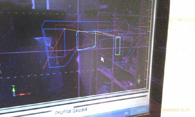

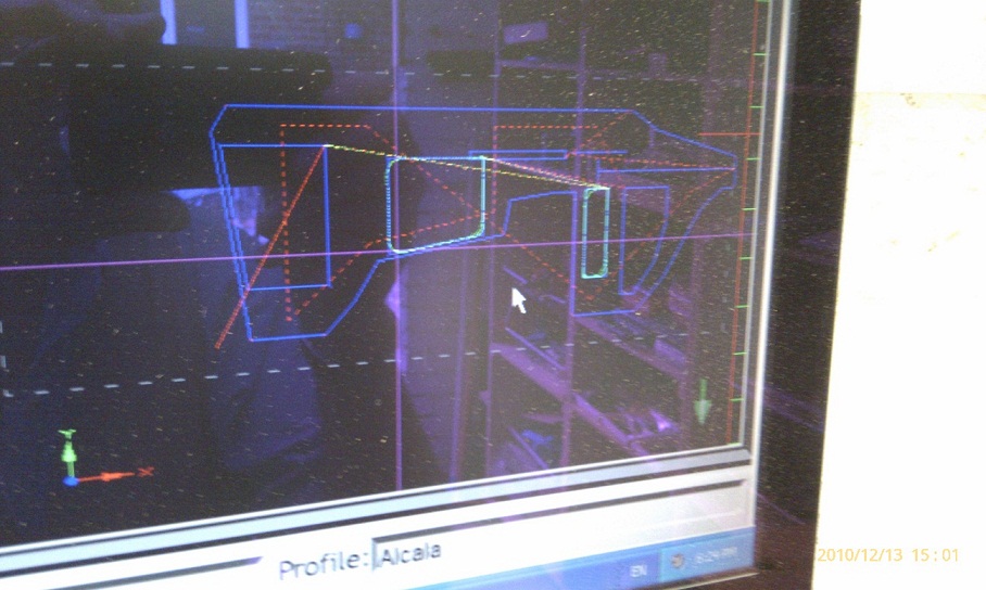

Just the design phase but work has finally stopped interfering with what i want to be doing so I will run some samples through the CNC machine tonight to get a feel for the layout.
I managed to get into Jaycar today and picked up the push solenoid, battery and trigger switch I needed so I will do some MDF mock ups of the lower receiver and work out where the parts will fit.
Hopefully the JPG will explain it a bit more. Sorry for the rubbish image but my CAD program does a bad job of DXF to JPG

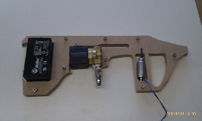

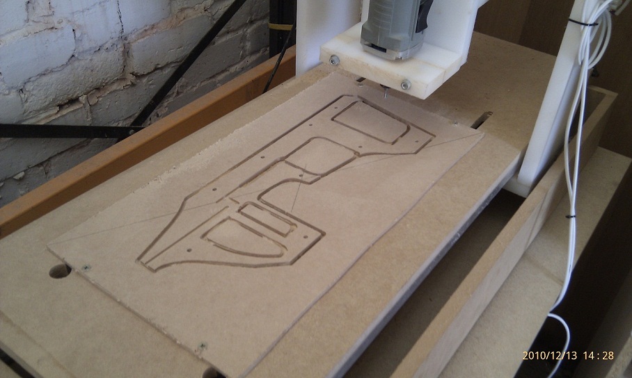

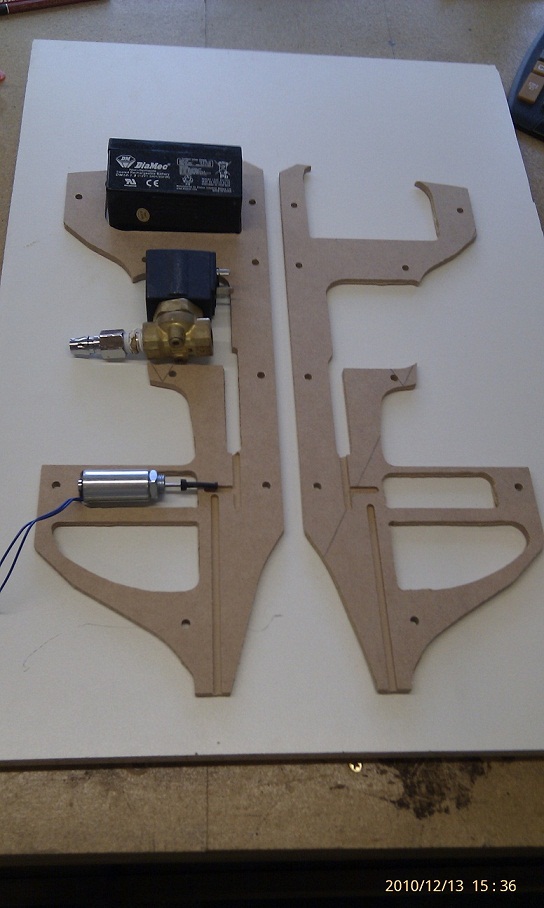

Making progress
The prototype for the receiver is taking shape, just using MDF for now, the final job will be a series of mm plates of black HDPE. The laminated idea is simply so I dont have to bore and align magazine feeds and barrel housing for the upper receiver; I just make them in mirror halves then bolt it all together. Makes it easier for upgrades and maintenance as well.
The next step is to make two more half shells, this time only pocketed for the equipment rather than cut all the way through.
Cheers
						Making progress
Cheers
