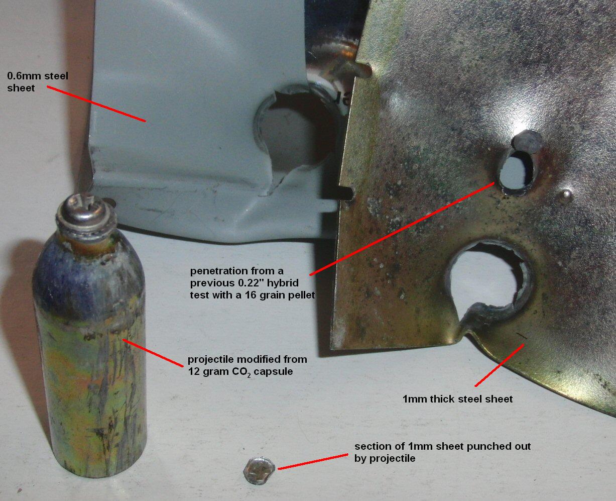

edit: took the 0.75" hybrid to 20x fired at 1mm steel plate over a 0.6mm power supply case, it didn't penetrate fully but still, impressive damage.
Too bloody loud though, there's enough propane/butane in the chamber to fuel a 500cc combustion :roll: not going to fire it any higher unless I make a barrel extenstion with a suppressor.

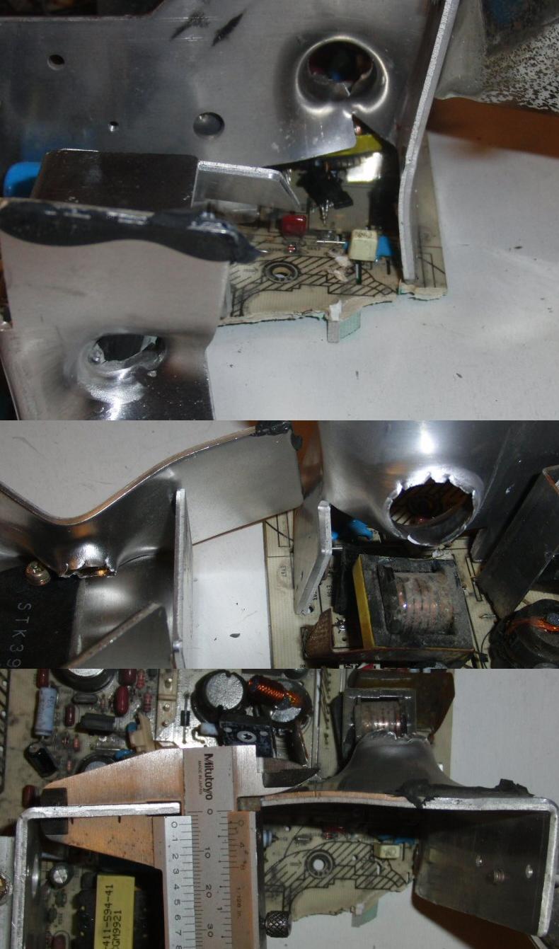

Lovely sunshine so it seemed a shame not to shoot it again :)
Here's an old Sagem cellphone donated years ago for target shooting purposes, finally being put to good use, 20x and 1000 frames per second ;)
Target is the 3mm (just under 1/8") alloy heat sink from the CRT monitor board that gave up the flyback ignition (does that count as self harm :D), fired at with an unmodified CO<sub>2</sub> capsule at 20x.
The projectile went through the heat sink but was stopped by the heatsink behind it, some photos showing entry and exit holes as well as heat sink thickness:
