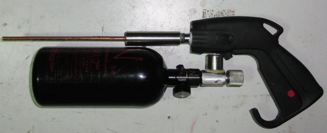

I've neglected this platform somewhat so it was worth a re-visit, especially now I have a bigger tank, and following the success I had with this airsoft BBMGit seemed worth making something similar for 0.177" BBs.
The seal seems to have worn out fairly quickly, rate of fire was a lot more reasonable before the above testing, but it's quite promising. Eventually I'd like to add an integral suppressor and a weaver rail for a red dot sight, and I'm almost tempted to do a BtB and lop off the end of the barrel to have it the same length as the tank :D

Sat Feb 12, 2011 8:26 am
Actually..a true BTB chop would mean the barrel is about 5mm shorter than the reservoir or whatever " under" you have for your " over"
This makes for the most brutal look.
I would think you'd noticed that... :wink:

Brian the brain wrote:I would think you'd noticed that... :wink:
I did... but I simply couldn't bear the loss of performance :?
By the way, did you search for "btb" to see where you've been mentioned of late :D
